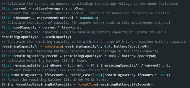

Step 2: Code
battery monitoring and data logging system utilizing a NodeMCU and an ADS1115 ADC to measure the voltage drop across a shunt resistor. It calculates the current draw and estimates the remaining battery capacity. The system is configurable for various deployment scenarios, dynamically downloading specific settings based on the device's MAC address. The loop continuously measures battery data, calculates averages, and sends SMS alerts if certain thresholds are crossed. Data is uploaded to MongoDB, allowing tracking and analysis. This code represents a customizable and scalable approach to battery management in IoT applications. Code here: https://github.com/darkmatter2222/Arduino_Battery_Backup_Monitor
