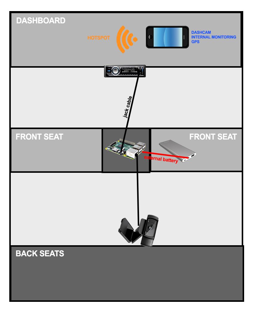

This system will be as follow:
- the Raspberry Pi working as a smart hub, plugged to the external battery and connected to the internet via the smartphone’s hotspot. You can either put it in the center platform of your car or hide it in the back pocket of one of the front seats.
- A webcam wire-connected to the Raspberry Pi, set on the back seats and facing the front of the car. It will allow you to remotely monitor what’s happening in your car while you’re away.
- A Jack cable connecting your Raspberry Pi to your radio set or external speakers.
- An old smartphone on the dashboard, which front camera allows monitoring of the inside of the car while the back camera works as a dashcam. The smartphone can of course also be used as GPS device.
- A USB stick on the Raspberry Pi will let you play all your favorite songs. You can easily set automation so that you can trigger the music from your phone with simple text commands (via Telegram messenger app) or with voice commands (if you have a smartphone with Siri or Google Assistant). The USB stick will also act as a ‘blackbox’ keeping snapshots from the inside of your car.

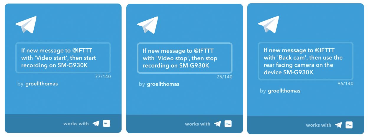

Dashcam remote controls
Through IFTTT, you can create text commands to remotely activate or deactivate your dash cam and switch the recording from front to back, depending on what use you need.

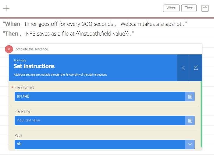

Let’s set up an automation that will take a snapshot every 15 minutes. That way, if anything happens to your car, you will be able to trace when it happened and probably what happened (depending on the visibility the camera has). With NFS app, your snapshots will be saved on the USB stick and remotely accessible from your computer online.
Write the following storyline: “When the timer goes off every 900 seconds, Webcam takes a snapshot then NFS uploads the file on USB stick”. The 900 seconds timer will ensure the photos are taken every 15 minutes.

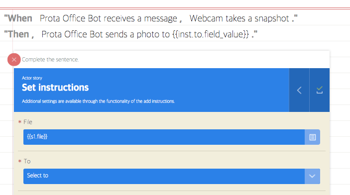

You can also get an on-demand visual report from your webcam. Simply write the following storyline “When i write “Report” to my Telegram Bot, webcam takes a snapshot then Telegram Bot send me the file”.
