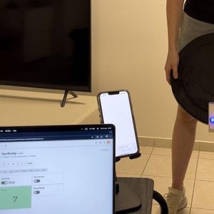

Introduction: DIY Smart Fitness Device That Counts Reps and Tracks Your Progress in the Gym
In this instructable, we'll guide you through the process of building your own GymBuddy, a device that counts reps and tracks your progress automatically. Using Arduino IDE and an ESP32 controller, we'll integrate it with Blynk and Make.com to enhance your workout experience.
This project includes the following features:
  • Start tracking your exercise effortlessly by pressing a button in our custom Blynk app or using Siri shortcuts, perfect for when your hands are occupied with weights. You can easily keep count of your reps without needing to remember them, and the app supports multiple exercises, as demonstrated in the video below. Your workout details are automatically saved to a Google Sheet, allowing you to log your weights and track your progress over time.
  • Take control of your workout environment by managing the room's air quality, whether by turning on a fan or AC, depending on your setup. You can also activate a fun light mode to enhance your mood. These features can be controlled via the Blynk app or Siri shortcuts as well.

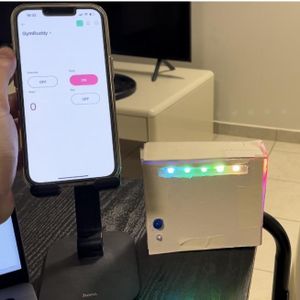

Feel free to get creative with the case part (and actually every part ). We recommend finding an empty box that fits the components perfectly. If you can't find one (like us), you can follow our steps.
With everything ready, we can dive into building your own GymBuddy.
Step 1: Connecting the Wires
  • LED strip - pin 15
  • IR sender - pin 26
  • Blue LED - pin 17
  • Accelerometer:
  • SCL - pin 22
  • SDA - pin 21

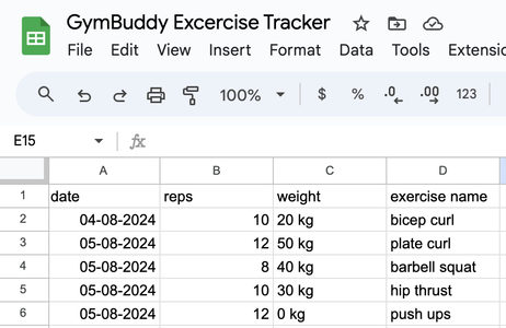

  6. Now we want to create our google sheets integration. There are of course many options you can choose from in Make.com. Choose the add a row option.
  7. You will need to connect your google account if you haven't done this before.
  8. Create a new Google Sheets document and define the columns you want, and a reps column.
  9. Define the date format, and connect reps to the webhook we created.

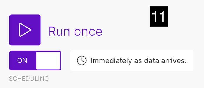

  10. Add scheduling, meaning that Make.com will listen to data arriving from the webhook.

Now we expect to see that the exercise data has been added to our google sheets file via Make.com

Step 8: Final Assembly and Test Run
In this final assembly step, we’ll bring together all the components into a single device. This process includes attaching the electronics, securing the connections, and making sure the device is both operational and comfortable to use.
  • Start by placing your ESP32 and battery compartment on the cardboard, leaving enough margin for the LED strip, LED blue light and IR sender cuts.
  • Cut the cardboard using the cutter knife, and use it to measure and cut another base from the cardboard.
  • Mark and cut slots for the LED strip, blue light and IR sender.
  • We want to turn this into a box, so use the sides of the base to measure and cut sides for out box.
  • Secure the components to your box using a strong tape.
  • Secure the box using a tape suitable for paper, so it doesn't rip the cardboard if you want to open the box.
  • Glue the adhesive fastener tape to the back of the box, and to the weights you are going to be using in your next exercise.
  • Attach the device to the weight, make sure it is turned on and secure
Final step
Once you've completed all the setup steps and verified the connections and configurations, it’s time to test the system and enjoy the peace of not having to forget how many reps you just did. Make sure all components are powered on and working properly.
Remember to open the Google Sheet we’ve created after your workout and log the weights you used for the best results.
