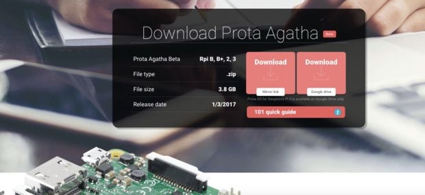

Step 2: SET UP YOUR PROTA PI
You first need to build the smart hub that will control the automation of your ring bell and connect all devices together. Prota OS for Raspberry Pi is our free smart hub OS which is very easy to install. In no time you will turn your Raspberry Pi into a smart home automation hub!
You can download Prota OS here . Then burn it on the SD card.
We made an easy guide you can follow to set up your Prota Pi.
Alternatively, you can check this Instructables .

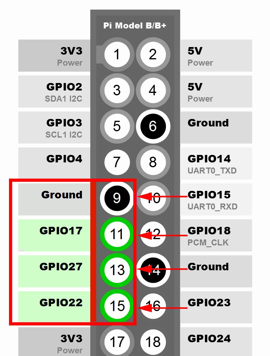

Now let’s connect the breadboard to your Raspberry Pi.
- Plug the ground wire (red wire) to PIN 9.
- Plug the button wires (white/black/brown wires) to the PIN 11/13/15

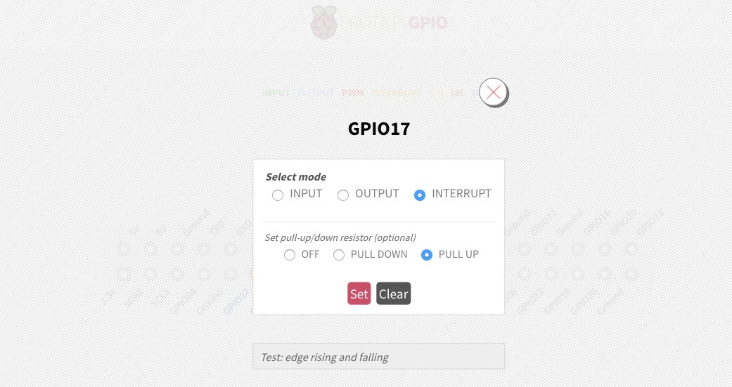

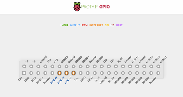

Step 5: SET UP GPIO APP
It’s time to set up your Prota OS apps to configure the buttons.
First, let’s take care of the GPIO settings
- Go to App Libraries and download the GPIO app
- Open GPIO app
- Select GPIO17 and set it up on Interrupt // Pull Up.
- Click on “Set” to confirm.
- Do the same for GPIO27 and GPIO22
You can make a test by pressing on your buttons. It should react by a “falling” and “rising” interrupt.

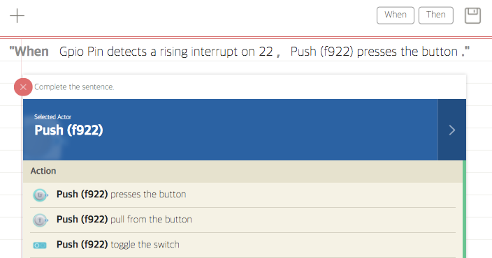

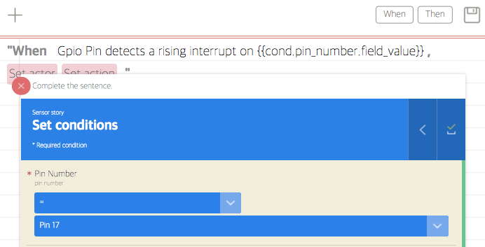

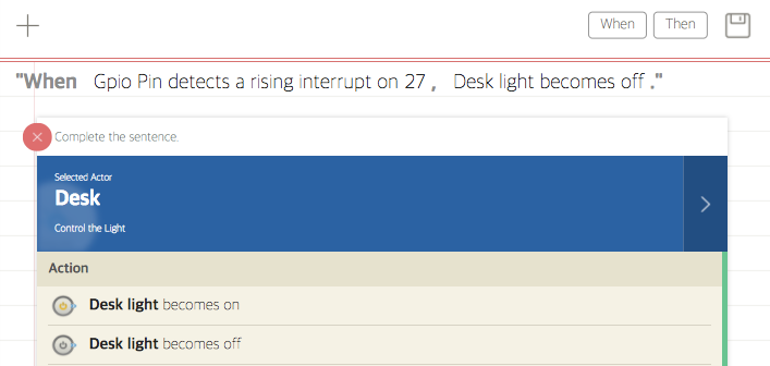

Step 7: SET UP YOUR AUTOMATION STORIES
Let’s now write down the storylines that will link the buttons to your lights
- Go to your Stories app
- Press on “+” and click on “When” to start writing a new storyline
- Select GPIO as Sensor and select “When Gpio Pin detects a rising interrupt on GPIO17” (this is your 1st button)
- Select ON/OFF as Actor and “socket turn off” as an action.
- Click on the save icon
Now you can create two other storylines for the two remaining buttons, linking GPIO27 and GPIO22 to respectively Philips Hue bulb and your MicroBot Push.
