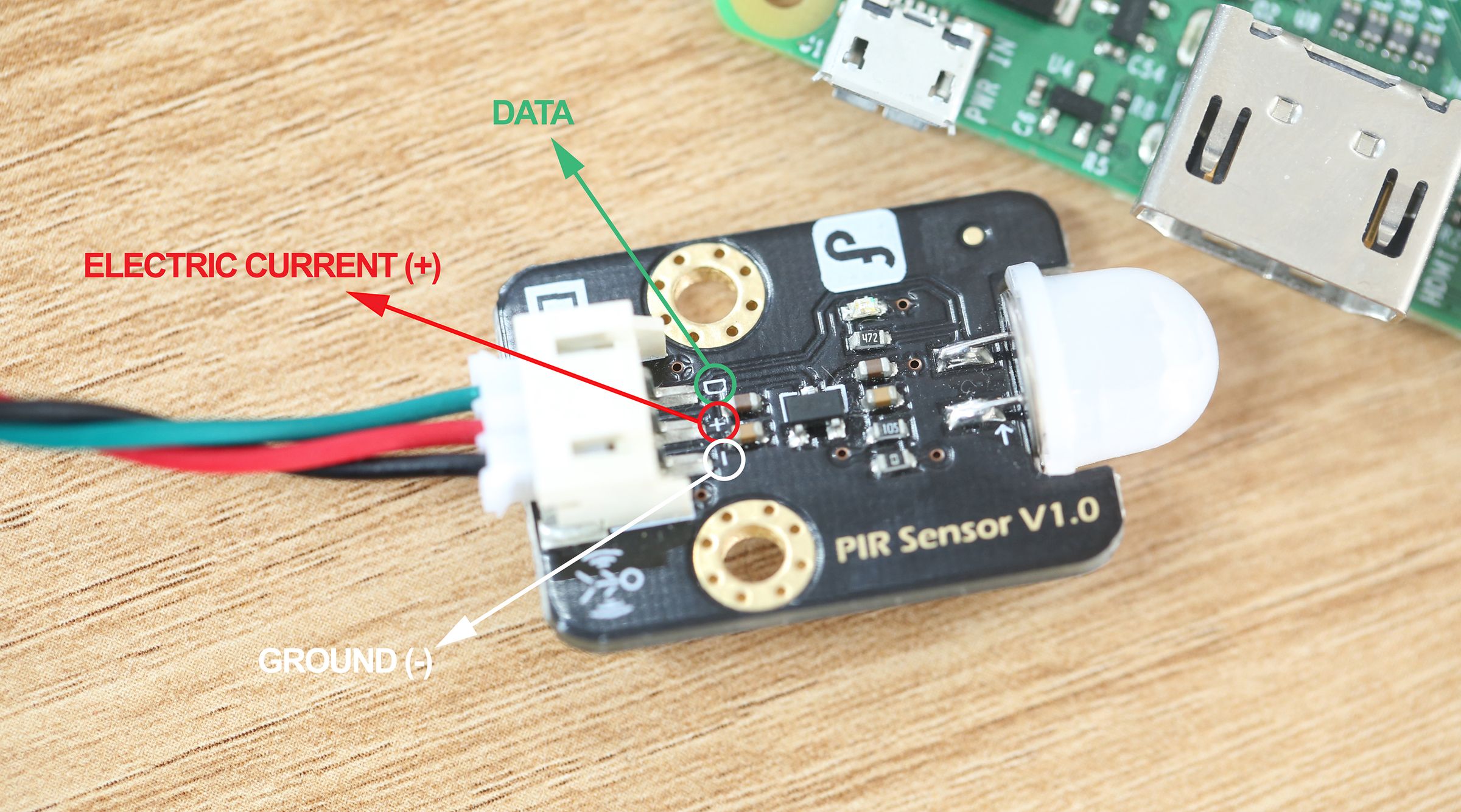

Step 3: SET UP YOUR PIR SENSOR
As you can see, next to your sensor’s pins are small indications on what each pin is made for:
- D is for Data
- + is for the current connection
- - is for the ground connection
Simply connect as in the picture below to set properly.
For the quick explanation, the RED cable is connected to a 5V pin (PIN02), the BLACK cable is connected to a ground pin (PIN 14) and the BLUE cable is connected to GPIO18 (PIN 12).
You can look at the map below if you need any direction.

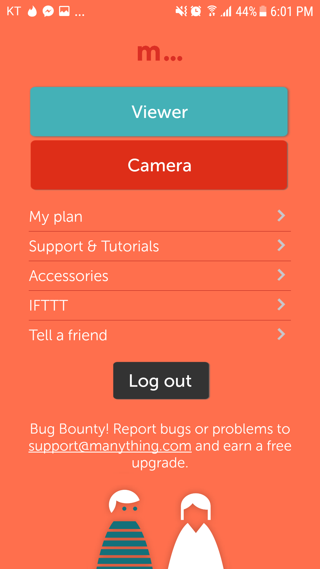

ManyThings is a web service that allows you to turn any smartphone or tablet into a smart camera by simply adding their app. You can also see a live stream and record particular moments when motion is detected, and since it is free for one camera, it’s a perfect service for our project!
Any phone that let you install this app can be used, and if it even has a frontal camera, you can make it film both sides, which is a great way to recycle your old smartphone!
- Download the app on iOS or PlayStore depending on the smartphone you will use as a webcam.

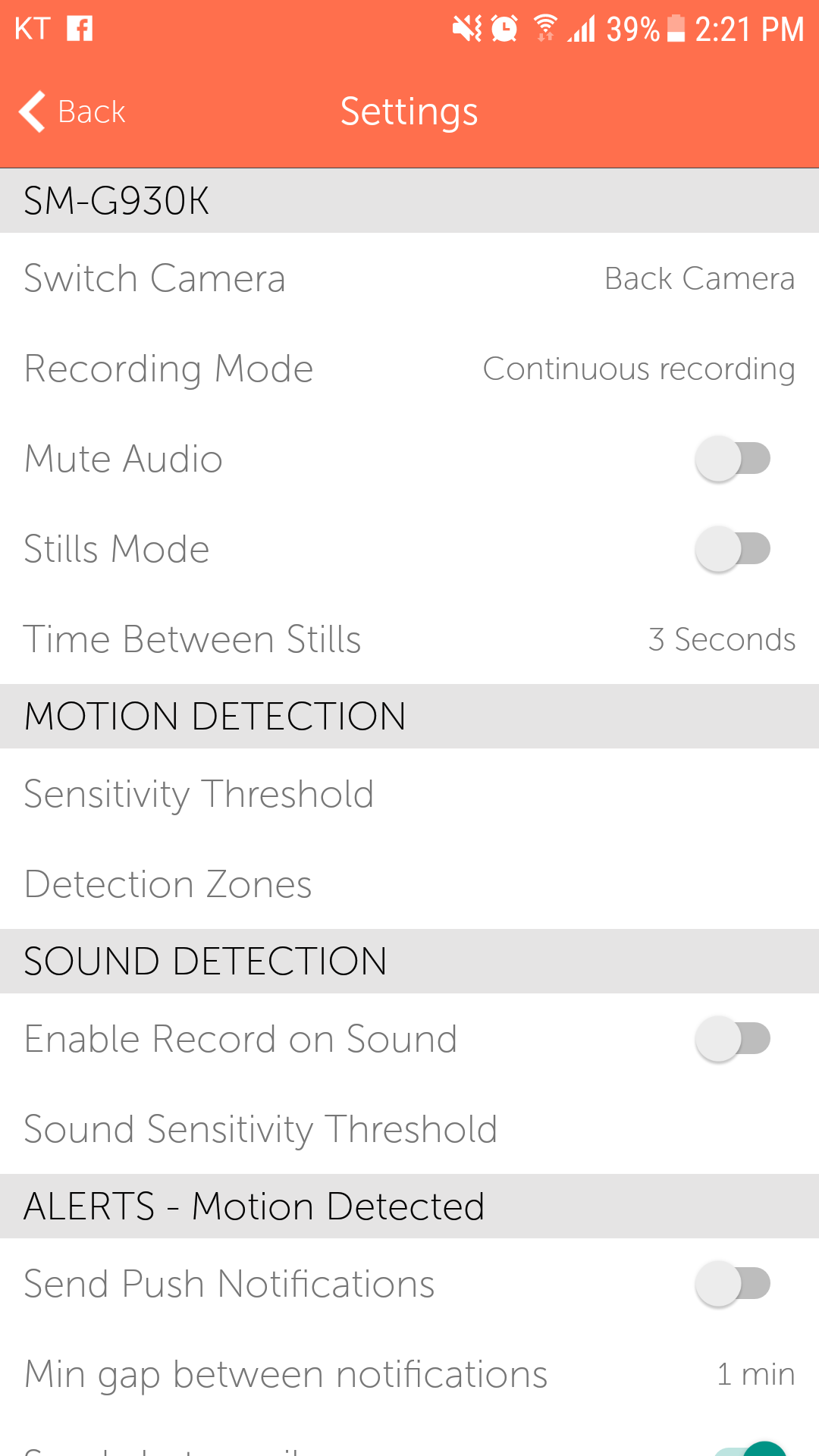

- Sign up and choose “Camera” to put it in Webcam mode (Viewer is the mode to use on the device from which you want to monitor).
Your phone will switch to camera mode and as soon as you press the red button it will start recording and live streaming.
- Go to manything.com or open the app on another device to monitor what is happening
- Have a look at the settings to define the threshold of motion (from 1 to 10), the notification and recording parameters and the detection area.

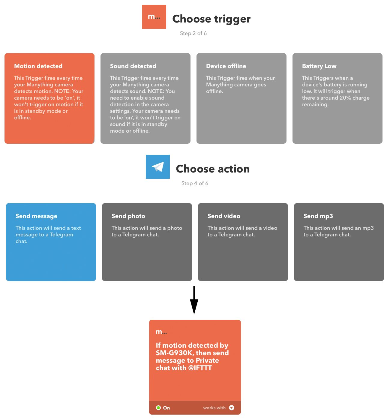

2. When my smartphone camera detects motion (camera #2), send me a notification to my Telegram account with a link to the video
- Open IFTTT and start a new applet
- Search Manything and select “Motion detected”. Select your device.
- Search Telegram and select “Send a message”. The default message will provide all necessary information, but you can edit it if you want.
- Click on finish

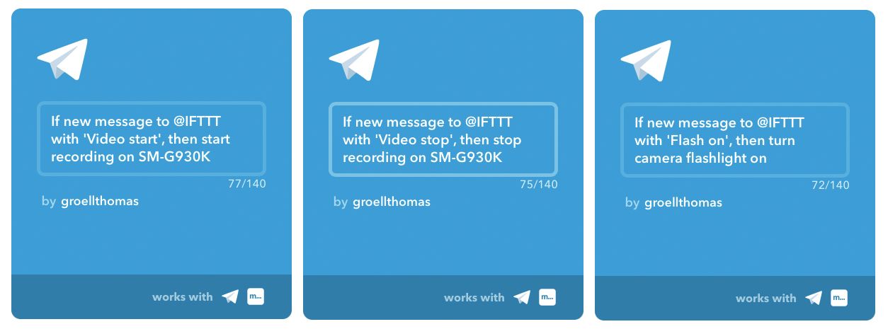

4. Use Telegram Bot to control camera #2 with simple messages
There is a many things you can tell your old smartphone’s camera to do via an IFTTT applet. The most important ones are start and stop recording, use front facing camera, turn on sound and motion emails, turn camera flashlight on. You can decide to create an automation to trigger those settings with a simple Telegram message to your IFTTT bot.
We will use here applets for start and stop recording (send message “Video start” and “Video stop”) and for the flashlight to be turned on (“Flash on”).

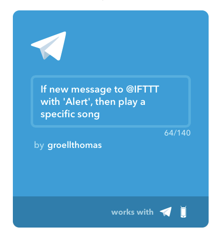

5. Use Telegram Bot to trigger an alarm when intruders have been detected
Let’s assume the worst! You look at your snapshots or live stream and realize intruders have gotten into your house. A good way to frighten them could be either to play a recorded message to make them think someone is here, or to play an alarm sound. Well with IFTTT, you can remotely trigger your phone to play such sound!
You can find many alarm sounds for free with a quick research. We recommend you this high pitch sound, highly disturbing! You can edit it to make it last a long time, or to add a vocal message.
Download it and put it on the old smartphone that will be used as camera. Make sure its name is recognizable, such as “High Pitch Alarm”.
Now let’s automate the alarm:
- Select Telegram - “New message” and set the trigger message as “Alert”
- Select Android Device - “Play a specific song” and write down the exact name of your track (for us it will be “High Pitch Alarm”)
Test it! Remember that you will have to set your smartphone on high level of media sound in order for the alarm to be efficient.
