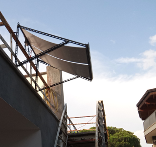

To build a PV system in a villa, I started with a 'plug-and-play' (or 'balcony') system for tests and measurements. From this first success, I am now moving on to more demanding systems.

  • simplicity of installation and connection
Easily movable: railing, terrace, window, wall...
Connectable to any existing socket
- semi-flexible solar panels, 100 Wp, 1050x530x3 mm, 1.9 Kg
- mini-inverter:
project A1: GM300 (or TSOL 350)
project A2: Y&H SG-300W (with WiFi)
I have tested them both, my preference goes for the second one.
Simple construction: details can be found here https://github.com/msillano/DIY-photovoltaic-smart/raw/main/fotovoltaico-part-A-v2-en.pdf.

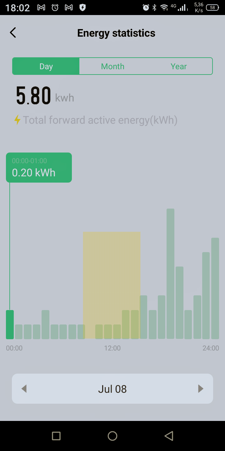

Step 2: Results
A balcony solar panel is an easy do-it-yourself project.
The 200 Wp DIY plug-and-play solar panel has the production shown between 9:00 and 15:00 (solar) in July, with a total between 0.6 and 0.7 kWh/day.
There is therefore a self-consumption of 100% if between 9:00 and 15:00 the electricity consumed is equal to or greater than the production (70-120 W).
In this case, the entire annual production (estimated 220 kWh ) is used, with an annual saving (considering 0.40 €/kWh on the bill) of €90.2. and a very short period of amortization (about 4 years), against the 20 years of presumed life.
