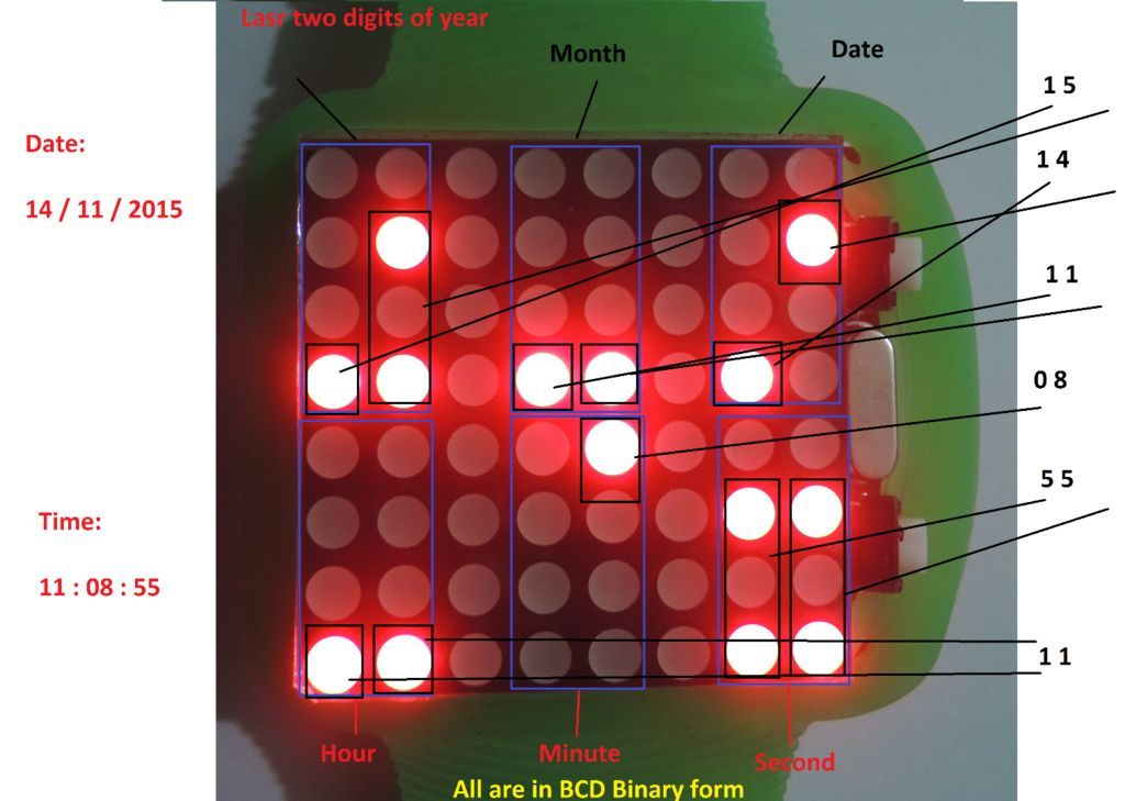

Step 8: Making Arduino Circuit
The main function of this circuit is to display the time and visualized the audio signal. As a display, an 8x8 dotmatrix display was used. For keeping the time DS3231 RTC module was used. The drive the display an Arduino NANO was used as a main controller board. Under the display two LED was attached to show the status of the Alexa. This two LEDs are connected to the Alexa Status Pin of the WisCore Board. The connection of the Arduino with the RTC module is very simple. Here is the connection:
Arduino | RTC Module |
VCC | VCC |
GND | GND |
SCL | SCL |
SDA | SDA |
Arduino NANO | Dot-matrix Module |
VCC | VCC |
GND | GND |
12 | DIN |
11 | CLK |
10 | CS(LOAD) |

IIf you followed all the previous steps then Congratulation. You made your smart speaker with a dot matrix display. The display shows audio and time. If the speaker receives any audio signal it shows audio spectrum otherwise shows date and time in BCD binary format. If you like programming and digital technology, then I am sure you like binary. I like binary and binary clock. Previously I made a binary wrist watch and time format are exactly the same as my previous watch. So, for the illustration about time format, I added a previous image of my watch without producing another.
