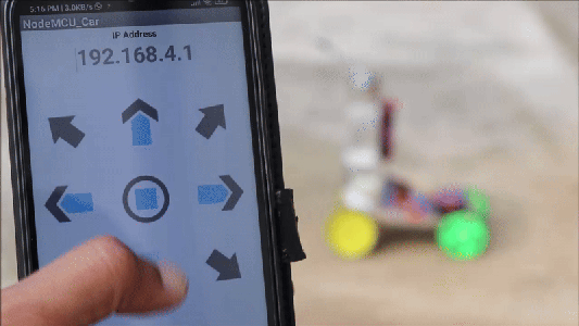

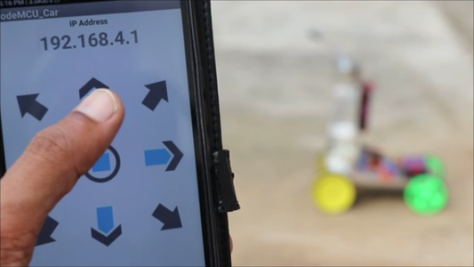

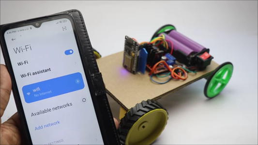

Like i mentioned earlier this robot is controlled using a phone and this means the connection is instant, all you have to do is turn on the robot and tur on wifi on your phone.
When you open the application the control panel opens up and there you go, You can control in all possible directions and all these steps will not even take a minute also.

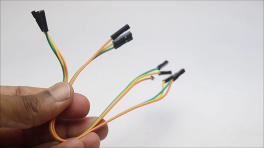

Jumper Cables

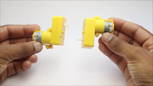

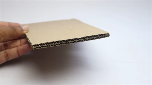

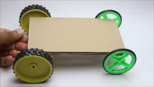

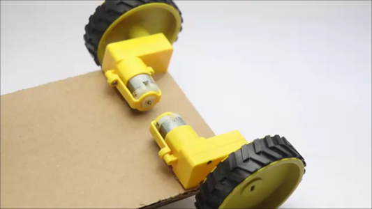

The base is the part that will hold the wheels and the electronics, i will be using thick corrugated board for much more durability you can add mdf wood board also
I wont recommend to use plastic frames here because it will disfigure in front of hot substances so this is the best option you can consider

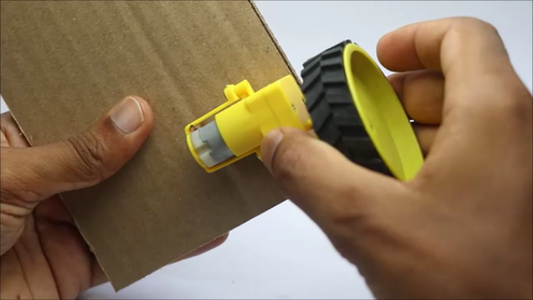

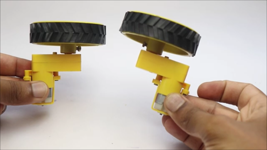

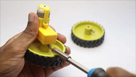

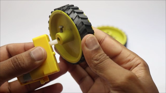

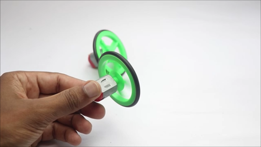

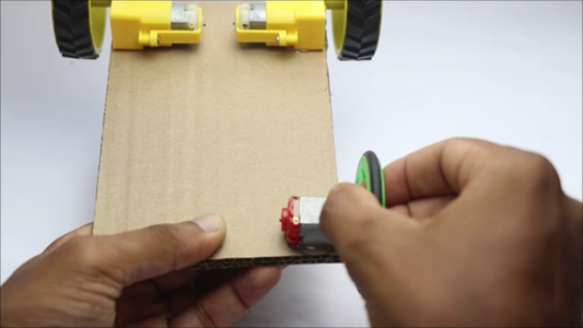

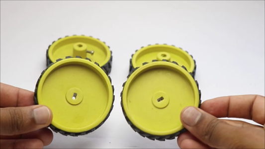

Start by connecting wheels to the shaft of BO motor and secure the wheels with the screws provided, Repeat the same step for other wheel also

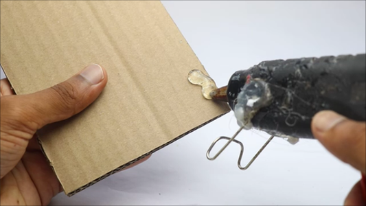

Add some hot glue to the edge of the frame and press the BO motor firmly on this and allow few seconds to dry completely
This will make the adhesion best and there will be no chances of this part coming off
End of this step we have the 2 front powered wheels ready and now for the rear wheels i will simply use the wheels connected to the dc motor
This will allow the wheels to run much more smoothly and it is also easy to connect to the frame
We now have the base ready and now you can work on the circuit that will eventually drive this motors

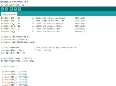

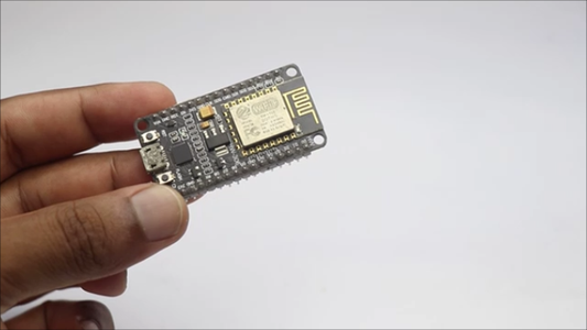

I recommend you to first upload the code to nodemcu, to do this open arduino ide and connect nodemcu board via programming cable
Copy and use the below code and by selecting proper board type and port upload the program to board and then proceed with circuit building

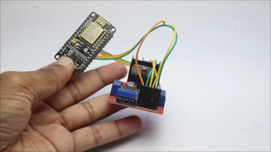

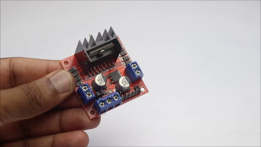

L298N driver is connected to NodeMCU as follows
The IN1, IN2 of L298N motor driver are connected to the D1, D2 of NodeMCU board
The IN3 AND IN4 pins of driver are connected to D3, and D4 pins of the NodeMCU.
Ena to D5 and Enb pin to D6 of the board
Hobby motors are directly connected to motor driver servo pins
There will be change in direction of rotation(sometimes) at this time you can simply interchange the pins of the motor that is connect with driver board
Battery that i used is 7.4v and positive of battery will be connect to 12v pin of driver and the gnd to gnd
From the driver board 5v and gnd is connected to Vin and gnd pin of nodemcu board

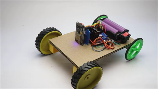

Step 3: Finishing the Circuit

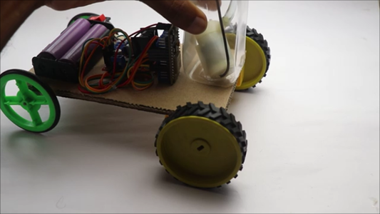

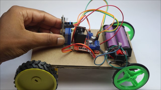

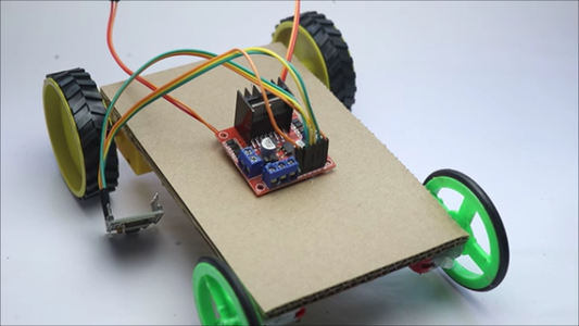

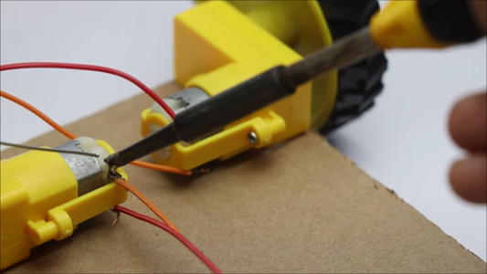

After we have the circuit connections ready we can move further to connect the dc motor to the driver and later finish the circuitry part

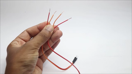

I have striped off the jumper cable and will be soldering them to the dc motor terminals, use wire splitter for this purpose
Repeat the same step for other set of motor pins and then via a small hole bring those cables to the top of the base as shown in the third image of this step
To glue the motor driver first cut and paste a small piece of cardboard to have a elevated surface and then place and glue the driver, as an alternative way you can simply use double sided adhesive also
Place the battery pack and to keep the battery in place i used some drops of hoe glue and later using a small piece of support i glued nodemcu board to the frame
Double check if any wires are disconnected or loosely connected when you are gluing the components since finding them later will be a time consuming task
Now make some adjustments so that all the wire are free from tangles and all the open ends are insulated using hot glue

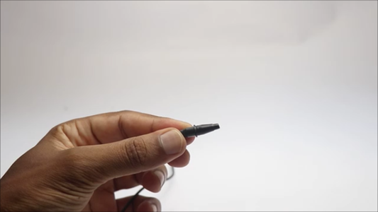

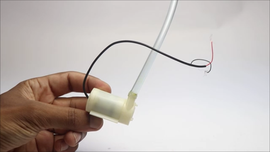

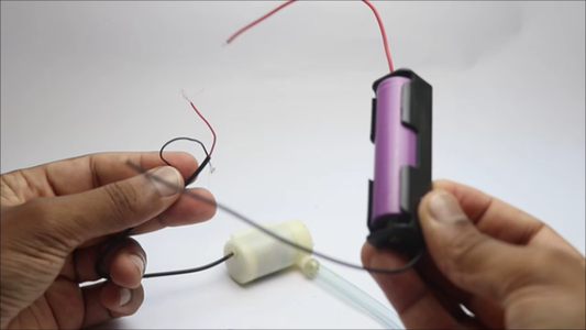

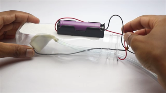

This is one of the main part of this robot, the submersible pump lifts the water from the container and sprays it all over and this should not happen and therefore i will be a using nozzle to spray the water to dedicated places.

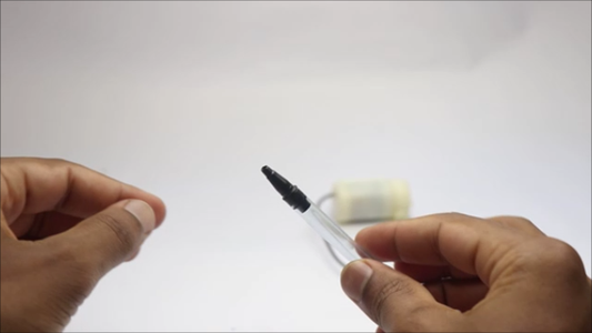

The simplest nozzle alternative was from the tip of the pen body, the inexpensive pens comes with removable nozzles and that served the purpose well in our project.
Use a small amount of superglue on the sides of this nozzle and immediately insert it into the hose and allow to dry completely
Now the other end of the hose will be connected to the submersible pump outlet part, Here there was no need of any glue since the fit was exactly what was needed

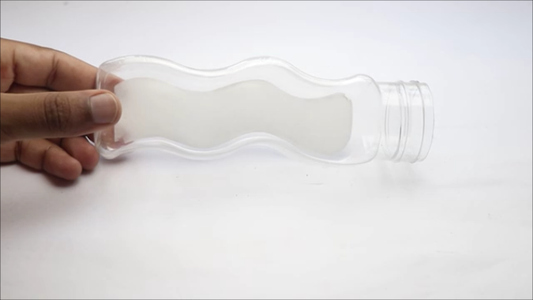

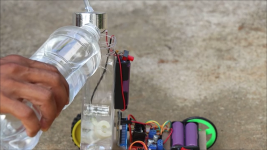

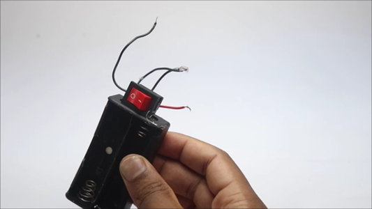

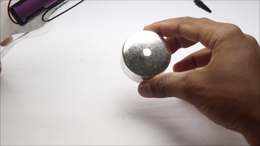

Insert this whole setup inside the bottle and the wire from pump is connected to single battery using the switch and all these are glued to the outside part of the bottle.
In the end make a hole the size of the hose and insert it before closing the lid of the bottle this will avoid the spillage of liquid when the robot is working
Finally glue the entire bottle to the base frame and make sure here you are using mild hot glue for the purpose, this will complete the process of building and next we can test the project for its working
Step 5: How to Use
Using this is too much fun and you will definitely love driving this robot but before here are few steps that you need to keep in mind! Don't worry its not that serious
Fill the water container with max level liquids so that you can have more water spray time, Close the lid and then turn on the switch
Before this make sure that the robot is connected to your phone and all the navigations are working properly, this robot can do front, back, left and right directions.

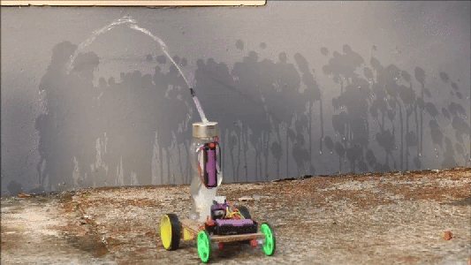

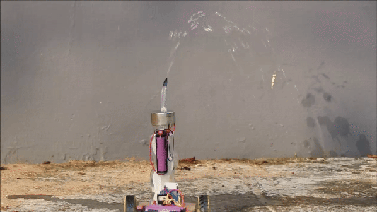

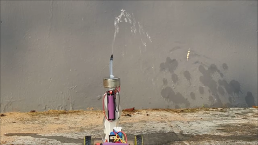

Turn on the water spray activation switch and now you have the robot ready for some actions, i have tested spraying this on a specific area on the wall and the result was good.
You can try running this robot on different terrains and see what results you will get, the 2 wheel drive was sufficient in my case but if you are using larger sized water container then you might need much larger sized containers
The rechargeable batteries used on both the robot and the water spray mechanism part had a larger backup time so that once you go ahead to complete the mission you will return only after its completed.
