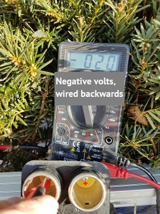

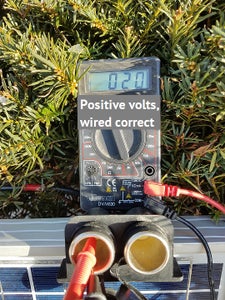

Step 3: Test the Socket
Bring your solar panel outside in the sun. With your volt meter, measure the output of the socket. Put the red probe inside to the metal circle on the bottom, and put the black probe on the outer metal ring.
If you measure a negative number, like -20V, the system is wired backwards. Figure out if you wired it wrong on the solar panel or on the socket. If you measure a positive number, like 20V, you are done!
