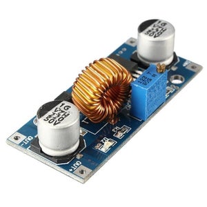

1. an XL4015 5A buck step down converter. This will be used as a solar charge controller. Set the output at 4.2V.

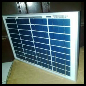

7. a Solar Panel. i used 3x10WP Monocrystalline solar panel.

The schematic is very simple. When there's no light, no current output from the buck converter so the transistor switched off, and the MOSFET's gate is charged through the 100K Ohms resistor and its switched on and the LED is ON. When there's a light, there's a current from the buck converter charged the transistor base and it will switch on and the MOSFET's gate is connected to the ground through the transistor and it will switched off, so the LED is OFF.

I made the light pole from cheap galvanized steel bars. The solar panel is mounted at the top of the pole facing north at 20º from the horizon.
