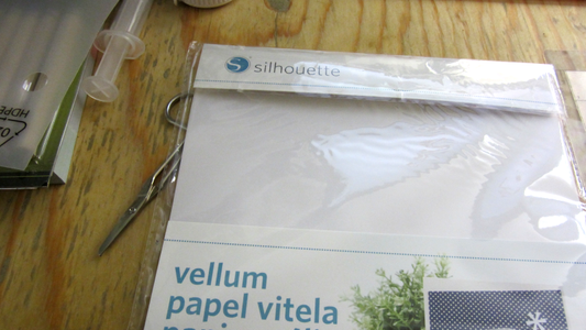

- Material you'd like to make your stencil out of. I proofed of concept-ed with Silhouette branded vellum

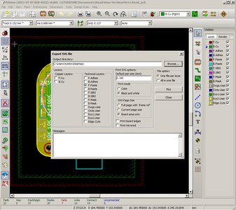

Step 1: Export Your SVG File

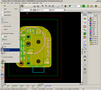

We use KiCad for our PCB designs, but if you use any other PCB design program, this should be easily done. First, you'll want to export an SVG file for the paste layers of your PCB. In our case, only one side of the PCB required exporting.

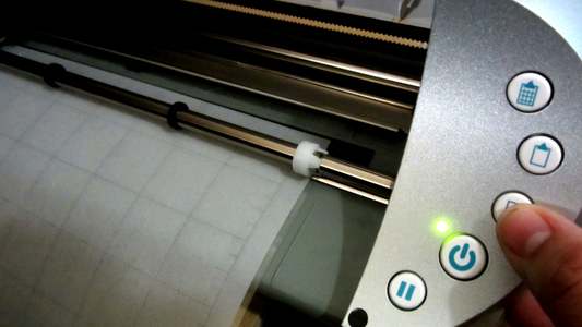

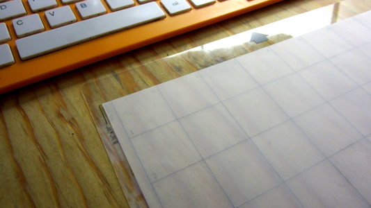

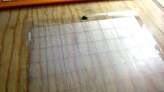

The settings on the Silhouette that I used for cutting the vellum were blade size 7, speed 1, and pressure 33. The Silhouette comes with a grid plastic sheet with one side which is sticky. This allows you to place your material on it and prevents unwanted movement as the blade cuts in.
Take one sheet of the vellum and attach it to the grid plastic sheet.
You'll then want to center this sheet between the rollers on the Silhouette Portrait and press the top button. This will automatically feed the plastic sheet to its starting spot. Be wary not to use the second button. I tried this and it ended up cutting ON the plastic sheet instead of my material - I think it didn't feed it through enough.
Go back to the Silhouette Studio program and "Send to Silhouette" via the top right icon. Press Start, and watch/listen the Silhouette cutter do its thing!

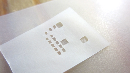

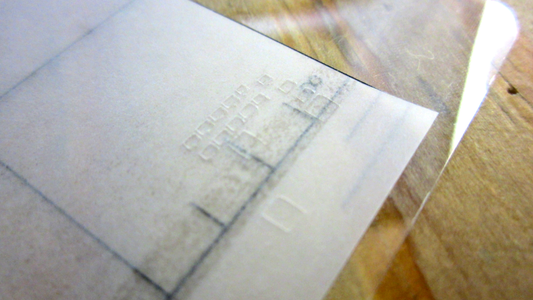

Step 6: Peel and Clean
When the cutting has completed, the Silhouette will reverse its rollers towards you. Finish unloading it by pressing the middle button. This will completely release the grid plastic sheet back to you.

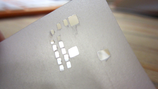

Since the SMT pads are so small, when you peel up the vellum, you may notice there are some straggling squares hanging on. Carefully get rid of these with tweezers or brush them away with your finger. With any luck, some of them will also stick to the sticking backing.
Nice thing about vellum is that it's strong enough that it won't tear easily, even when you're cleaning the little hanging bits off.

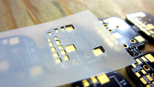

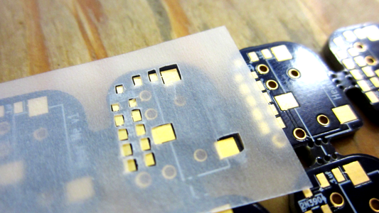

Step 7: Compare to Your Board!

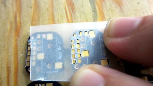

This is where you get to see how it compares to your board, to see whether it will actually work as a stencil for you!
And this looked nearly perfect!

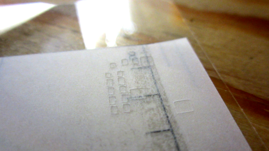

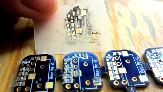

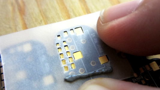

Step 8: Use It As an Actual Stencil!

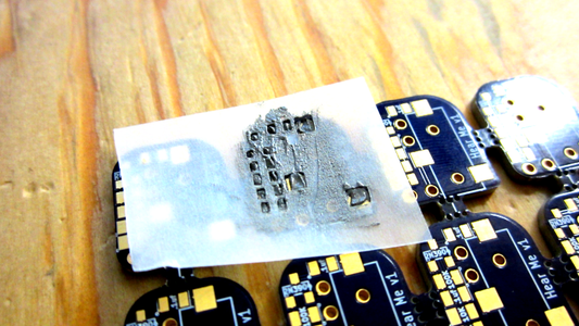

To test this, I placed it down, put a line of solder paste on one side, and essentially squeegee'd it towards the other side. I had to add a few more spots of solder paste to get enough, but if you look at the end result, it turned out to be a workable solution that saved me from having to individually solder 16 points!
The components on this board were mostly 0805s and the smallest was a SOT-23.
