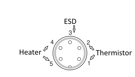

First of all, there are many clones of HAKKO 907 handles and there are at least two variations of the original HAKKO irons (with A1321 and A1322 ceramic heater).
Cheap $2-3 clones are an early examples of non-genuine parts. They use a K-type thermocouple and very crappy ceramic heater (or simple nichrome coil).
More expensive $6.00-$7.00 clones are almost identical to original HAKKO 907. The only way you can distinguish clone from an original is by markings on the wire insulation or possible absence of HAKKO brand and model number on ceramic heater itself. I was really lucky and got this one.
You can check whether your part is genuine by measuring the resistance between pins or heating element wiring:
ORIGINAL OR GOOD CLONE:
Heater: 3-4Ohm
Thermistor: 50-55Ohm at room temperature
Tip to ESD pin: < 2Ohm
EVIL CLONES:
Heater: 0-2Ohm for Nichrome heating, >10Ohm for crappy ceramic
Thermocouple: 0-1Ohm
Tip to ESD: < 2Ohm
NOTE: If your heating element resistance is very high, it is most likely damaged. You should ask for replacement(if possible), or purchase a new genuine A1321 ceramic heating element.

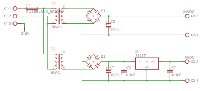

POWER
To make things a bit confusing I have drawn my transformer as two transformers. The circuitry itself is very easy and you should have no problems understanding it.
1) At the output of each secondary we will put a rectifier bridge. I bought a few small 1000V 2A bridges, which should be good enough. The transformer itself only outputs 2A max on 24V line and the iron is rated at 50W, so our theoretical max power is going to be around 48W.
2) 24V DC output also has a smoothing 35V 2200uF capacitor. This might be an overkill, but in the future we will probably connect some more stuff to 24V line besides ceramic heater.
3) I've used an LM7805T voltage regulator with some capacitors to drop 9VDC to 5VDC to power up the control board with all logic components.
