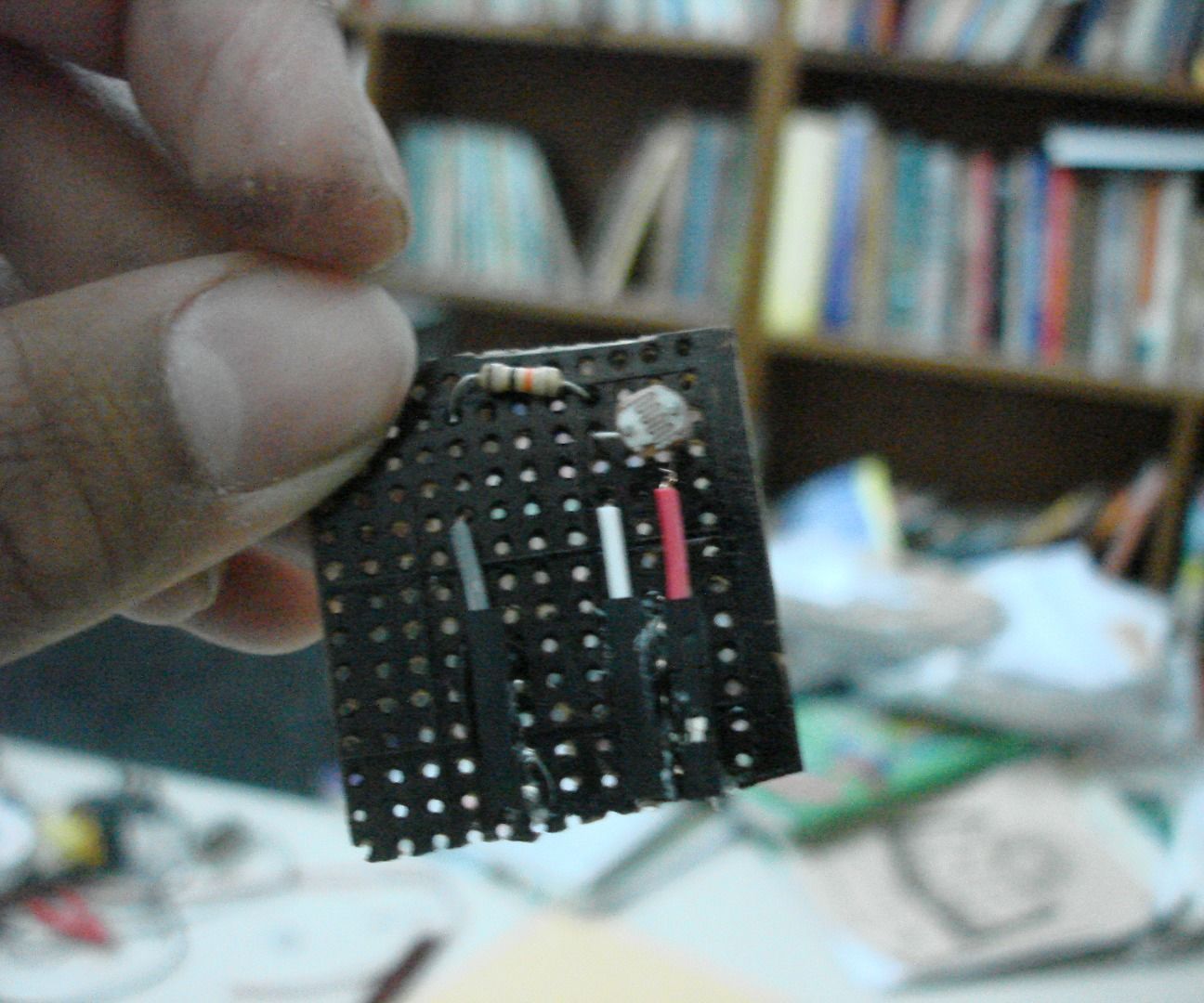

Glue two crocodile clip to one corner of the circuit board. 1 clip will also work,but 2 clips helps to keep the circuit stable while I solder. 2 clips also allow me to solder 2 small circuits at one. Also,glue one clothe-clip to another corner of the box. This is to hold bigger circuits.
