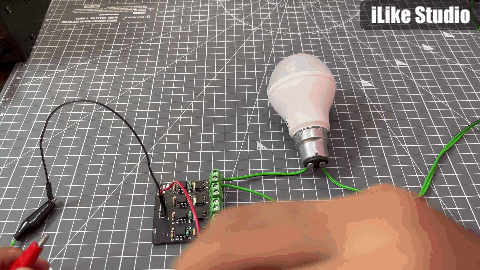

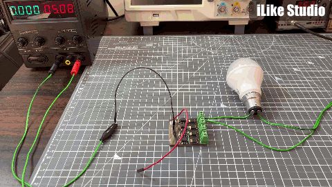

I made the PCB according to the channel selection; the front header can be directly used with the microcontroller. No need to made any external circuit for the driver section. The load can be directly driven through TRIAC driver. The digital pin (logic high) sets the output of 1st channel to high, a total of 4 channels are there which can be used separately with different GPIO pins.
I used black color, 1.6mm thickness, FR4 material and ENIG finishing in this design. All the required files are given here you can use them if want to make the same project. JLCPCB provides the most reliable and professional service for the SMT and PCBA orders starting from $8. Sign-up using this link and get $54 new user coupons for the next PCB order.
Step 7: Working of SSR:
This Solid-state relay is working in the same manner as mechanical sugar cube relays, but this time we have only two terminals. One is common and other one is NO (Normally open). Basically, the resistance is controlled at the output. When there is no trigger on the Gate pin the TRIAC output resistance in Mega-ohms which switch off the appliances connected to it. You can see the different TRIAC parameters directly from the datasheet. This module is working fine on +5volts and consuming just 10mA of current which is way lesser than old mechanical relays. You can also change the driver in order to make a dimmer AC circuit using the same TRIAC. A very thanks to JLCPCB SMT assembly service for the SSR prototypes.
