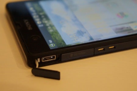

How often do you charge your phone? Internet geeks like me will need it charged daily. What is crossing my mind is : If I open the charging port cover daily, I might break it one day. So, better use the open pogo pins for charging.

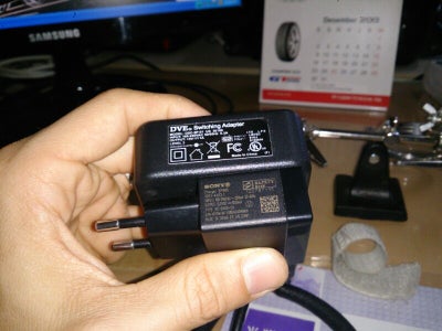

The original DK-26 was about $30 and I think now it has down to about $16. The cheaper version L36h is around $9.

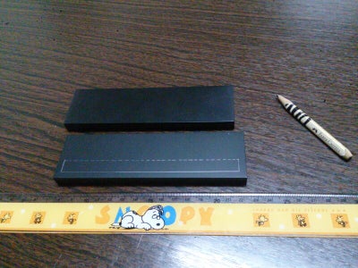

Step 2: Cut Out Top Deck

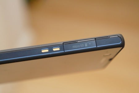

For the lower deck we have to measure from the left where your pogo pins be when laying in. Well, the pogo pins have 3mm wide on the phone. The holes we are going to drill are where the connectors will come out. So you need to make sure the connectors will touch the pogo pins. Drill a small hole with PCB hand drill for each pogo pin, so here we drill two holes.

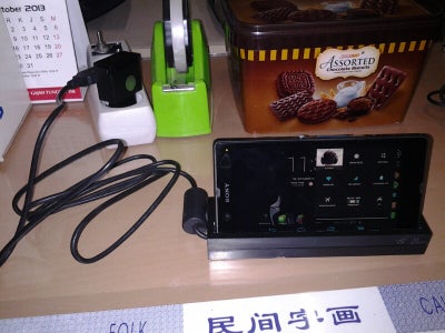

Now you don't have to open the usb port cover for charging.

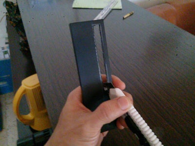

Cut the top deck as you can see in the picture. It is about 15mm from the left and the right of the top deck, or you can adjust it as long as you can access the navigation keys with your finger.
Stick it on top of lower deck so that it covers the thin foam and the connector pins when we put the phone in.
