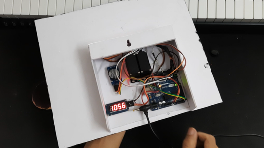

Step 4: Assembling the Electronics
Referencing the attached image, assemble the electronic components and securely attach them to the back of clock, as shown in the attached images. Utilize the Fusion 360 file included in the supplies section for reference. TM1637 display module is optional.
Step 5: The Code
After assembling the electronic components, upload the following code to the Arduino. Ensure to install the necessary libraries. For the DS3231 library, I obtained the zip file from a website called rinky-dinky electronics. Make sure to set the right time in your RTC (Here, I used DS3231 )module, there are a lot of Youtube videos out there explaining how to set time in an RTC module.

Step 6: Final Assembly
Next, we'll connect the power supply to the clock and set the hour and minute hands to their designated positions, as shown in the above pictures. To secure the planet cutout in place, we'll use double-sided tape, stacking four layers to create the necessary space for the hour and minute hands to move without obstruction. With this our build is complete.
