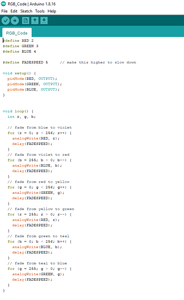

Step 12: Upload the Code to Arduino
Connect TTL FT232RL to Arduino pro mini. Then upload the code.
