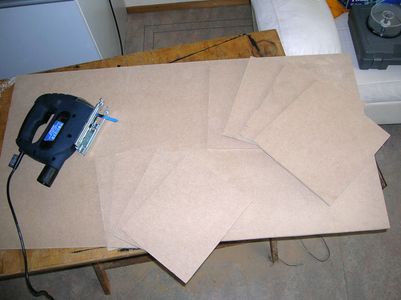

Step 2: Measuring the Case
The case is:
25 cm high
20 cm wide
28 cm long
I made it a bit bigger than the speaker needs ia a car to improve the sound quality.
Saw the mdf wood with the jigsaw. Use a saw with small teeth.
25 cm high
20 cm wide
28 cm long
