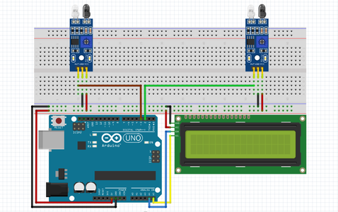

Step 2: Create Circuit Diagram for Arduino Speed Sensor
Here is an Breadboard Versioned Circuit Diagram for our Arduino Speed Detector.

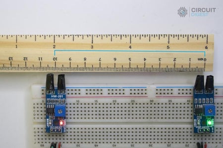

Step 3: Start to Build an Hardware Setup
Here is the actual hardware setup developed by using our Arduino sensor circuit diagram as a reference. Here you can see that I am powering this whole setup from the external power adapter through a 12V DC jack.
If you are facing any issues or having an query related to hardware setup, you can reach our here, where I provide a complete details related to hardware setup.
