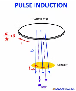

Pulse Induction (PI) metal detector operates on a principle based on sending short pulses of electrical current through a coil to create a magnetic field. This pulse lasts for a very short period, usually microseconds. When the pulse is transmitted, the magnetic field spreads outward from the coil. If there is a metal object near the coil, it disrupts this magnetic field. The coil then detects the change in the magnetic field caused by the metal object, and that results in a reflected pulse which is different from the normal pulse.
This difference is processed and emitted in the form of a sound or short beeps, with a frequency that changes depending on the distance and dimensions of the detected metal object. In several of my previous videos, I presented ways to make such a metal detector, including one very similar, with an Arduino Nano microcontroller. This time the device uses a more powerful ESP32 microcontroller board that also contains built-in Bluetooth, so now the construction is even simpler.

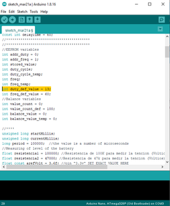

During the initial testing, I was unable to fully activate the Android application. The Bluetooth connection was established normally, but at the moment when I pressed the refresh button of the application, it disappeared from the screen, or an error appeared, depending on the version of the Android OS. Since the application is not mine and I normally do not have the conditions and knowledge for any modifications, I focused on modifying the input part with the microcontroller, or Arduino code. The changes consist of the following: I changed the order of the initial duty cycle value from 16 to 13, and the corrected line in the code looks like this:
After this, the Android application will work normally and we can start testing. First, let me explain how the application works. After the first start, we go to setup and select the metal detector version Spirit PI. Then we go to Bluetooth settings and select ESP32-Spirit PI-2 and go back.
