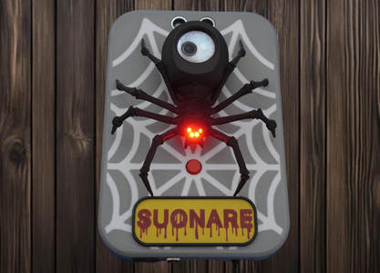

In this guide, we will build a spooky Spider Doorbell powered by an ESP32, sensors, LEDs, and a custom 3D printed case. When someoneapproaches, the spider’s eyes will glow red, an eerie eye will appear on the round display, and achilling sound will play.

Step 5: 🎃 Final Assembly & Test
With all components wired and programmed, the spider body is mounted over the electronics. Thedisplay and button caps are fixed, and the front plate with the engraved label is glued in place. Powering the device brings it to life: as someone approaches, the red eyes glow, the displayreveals its chilling stare, and the chosen sound plays. A perfect Halloween addition to surpriseguests at the door!
