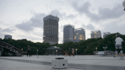

Push buttons, also known as tactile switches, can be found everywhere from simple lamps, doorbells to large industrial machines. There are so many kinds of push buttons, but I like the arcade push buttons most because they usually have a great tactile, "clicky” feel. I have several arcade buttons in my toolbox, and I always want to make something with them. Lately, I've been working out. One day an idea comes to my mind, can I turn my arcade buttons into a device that helps me do sports? Sounds not bad. I decided to give it a try.
Thoughts
I am going to make 4 sports push buttons, one as a master node with a screen that supports a menu display and the other three as salve nodes. They are all based on ESP32-C3, a micro Beetle controller from DFRobot. It integrates a battery charging management function, which allows us to connect a lithium battery to it as a mobile power supply for the project, or charge the battery from the controller's USB-C port when the battery is low. Also, to make them more interactive, I will add some sound and lighting to the push buttons.

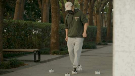

Step 5: Start to Play
In the program, I set three modes for the buttons. Short press to select mode, press and hold for 2 seconds to confirm or enter the selection menu.

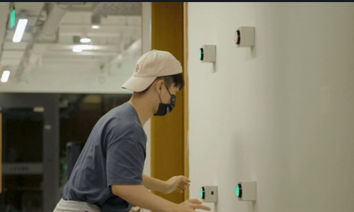

Mode 1- Whac-A-Mole
In this mode, all 4 buttons show green light at first, then one of them changes to red randomly, and we need to hit the red one within a certain time to score. They can be played in various ways.

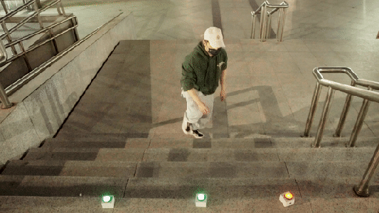

Mode 2- Relay Race Mode
In this mode, hit the first button, then the second will light up green. Just like a relay race, the green light acts like a baton, which will be transferred one by one among four members repeatedly.

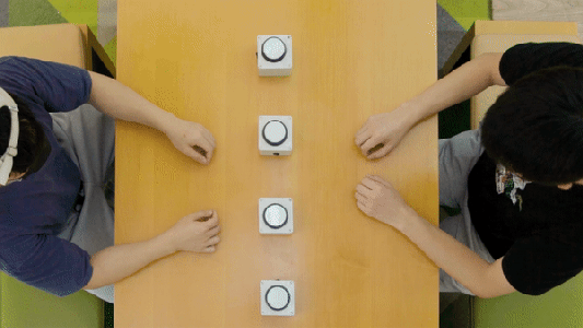

Mode 3- Random Picker Mode
When entering this mode, 4 buttons repeatedly show blue light in order, hit the main button(button with screen), and this time the button whose light turns on in blue will be the picked one.
