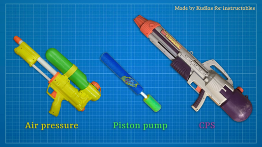

Step 1: Types of Water Guns
Before diving into the construction of our DIY water gun, it’s a good idea to understand the basic types of water guns available on the market. Each type has its unique mechanism, set of advantages and can be electrified. By exploring these, we can effectively decide on the best design for our project.
Air Pressure Water Gun
This is one of the most common types and often looks like an alien weapon from the "Mars Attacks!" movie. These water guns use a manual pump to pressurize air inside a reservoir. When the trigger is pulled, the pressurized air forces water out of the nozzle. While the design is relatively simple it is not so easy to manufacture in DIY conditions. Moreover, the pressure tends to drop with each shot, leading to inconsistent performance.
Piston Pump Water Gun
This type uses a piston pump mechanism to manually force water out of the nozzle with each pump and is the king of every pool party. The key advantage here is the high output with each pump, eliminating the need for pressurization. However, the downside is that it requires continuous manual pumping and has a small reservoir in comparison to other types...can we use it as a part of this project?
CPS Water Guns
Finally, we have the Constant Pressure System (CPS) water guns, a game-changer in water gun technology (since 90'). CPS water guns use a rubber bladder that expands as it fills with water. The elasticity of the bladder maintains consistent pressure. This design addresses the main issues found in air pressure and piston pump water guns, providing a great range and consistent performance.

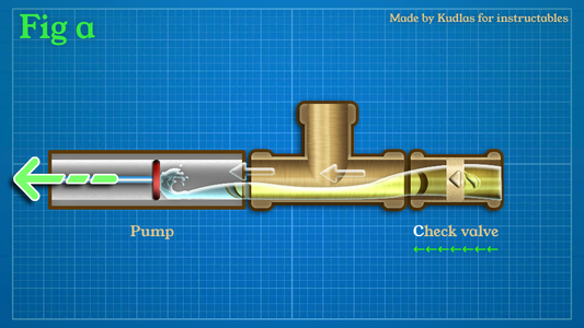

Our CPS water gun design relies on a series of water check valves and a manual pump. Here’s a step-by-step breakdown of how the system operates:
When the pump handle is pulled back (fig a), it creates suction. This draws water into the system, through the first check valve. This valve prevents water from flowing back when the pump handle is pushed forward.
As the pump handle is pushed forward (fig b), it forces water to move through the T-fitting to the next section. The water then passes through another check valve, ensuring that water won't return to the pump during the next pullback.
The water flows into the latex tubing, which acts as an expandable bladder. As the tubing fills, it stretches and builds up pressure. From the latex tubing, water has only one way to escape, which is through the barrel of the water gun. When the trigger is pulled, the pressurized water is released through the nozzle.

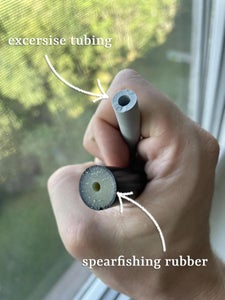

Step 6: Bladder
For builds like this, people often use McMaster-Carr to purchase all the required soft latex rubber tubing. However, this e-shop is not available in Europe, so I had to find an alternative. Initially, I found locally sourced latex tubing for exercise, which is basically 10x5 mm latex tubing, sold under a brand name at a higher price.
I tried using this exercise tubing, and while it worked, the performance was not as powerful as I had hoped. I needed a better option, so I turned to Aliexpress and similar sites. I initially searched for latex tubing, and the results were less than satisfactory. Later I discovered that latex tubing is also used for spearfishing, and the selection for this product was extensive.
After some research, I ordered the thickest tubing I could find: 16x3 mm latex tubing. This tubing provided the necessary pressure for our CPS build. My only concern was how to connect latex tubing with a 3 mm hole to 1/2" piping.

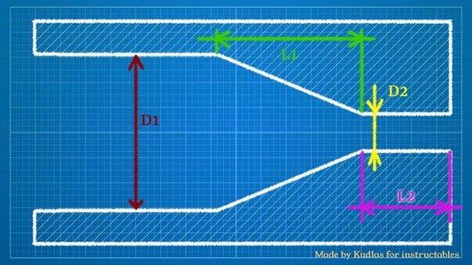

Step 12: Calculating the Nozzle
After my research, I found out that a converging nozzle is the right choice. It accelerates water flow and increases pressure as the water exits. This design transitions the water from a larger to a smaller diameter and with the right dimensions, it makes shoot range longer, instead of making a sprayer.
I first measured the piping with my cheap digital calipers and used these values, to calculate proper dimensions for these calculations.
Nozzle Design Formula
To calculate nozzle design we need four variables.
- Initial Diameter (D1): for this project, this is the inner diameter of the upper piping.
- Exit Diameter (D2): the hole at the end of the nozzle, sets the thickness of our water stream.
- Length (L1): the length of the cone-shaped part.
- Length (L2): the length of the exit diameter part.
Calculation
For this specific case, the numbers are:
- Initial Diameter (D1): 5.9mm
- Exit Diameter (D2): calculated as one-third of the D1, so 5.9mm/3 = 1.97mm
- Length (L1): 2 times D1, 5.9mm*2 = 11.8mm
- Length (L2): one to two times the exit diameter, I used 3mm.
I used these values to design a nozzle in Fusion 360. Now, to move things around...

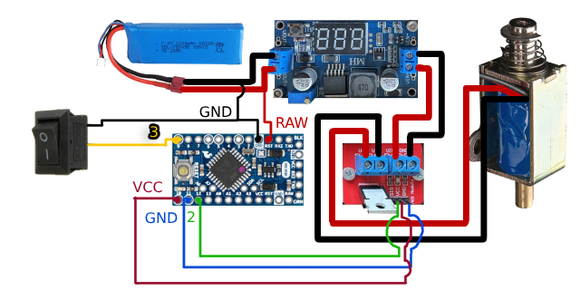

Step 13: Electronics
To give this water gun multiple shooting modes - a continuous stream, rapid bursts with adjustable burst cadence - I decided to use an Arduino Pro Mini.
Why Arduino?
The Arduino Pro Mini allows for easy implementation of these features. To control the solenoid valve, the Arduino is connected through a MOSFET, as its digital pins can't provide enough current to drive the solenoid directly. The MOSFET acts as a switch, enabling a higher current from an external power source to flow to the solenoid when activated by the Arduino. I used a MOSFET module from a previous project to avoid soldering.
Powering the Solenoid
The solenoid requires 24V to operate, so I used a 5A voltage boost converter to step up the voltage from approximately 12V to 24V. This converter ensures a stable power supply and displays the battery voltage on a digital display - something Ellen Ripley would be proud of!
Enclosure and Connections
I 3D printed an enclosure with holes specifically designed for all the components. To avoid soldering and allow for easy adjustments, I crimped all the cables and connected the components using FASTON terminals and pin connectors. The box has screws for + and - power, and all components that need 12V connect to this. I added an on/off switch between the battery + wire and the + screw to turn the electronics off when needed.
For shooting modes, there's another on/off switch connected to the Arduino. I used an old computer switch as the trigger pushbutton, which conveniently already had the right connector for the Arduino.
I've attached the Arduino code file for this project.
