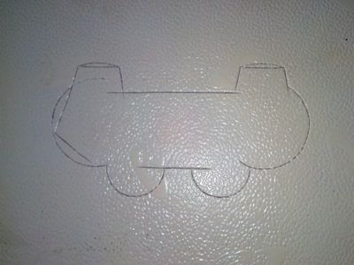

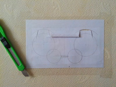

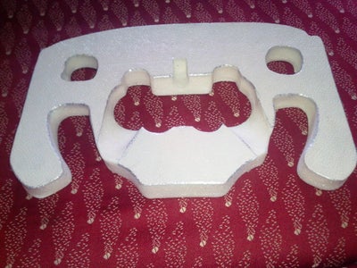

Step 4: Steering Wheel Design
I Google
for the various F1 wheel from which I selected this one and took the print out
then I placed this print on the PIR panel sheet after that I cut
the edges according to the drawing as u can see in the below pic.
After cutting, The edges were smooth en by emery paper from all sides.

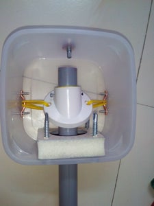

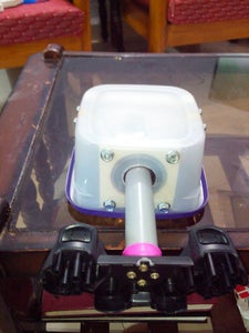

Step 5: Steering Shaft
Now for making steering gear I took pvc pipe on which I put a bulb holder but it was freely moving from one end to other so I inserted a cap(yellow colour) to make it tight, cap I used is from the candy bottle u can use cold drink caps also .

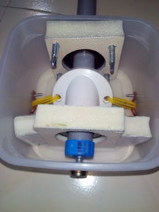

Step 6: Bearing Housing
Now for ball bearing I want housing which I have made it from the similar PIR panel sheet.
Step 7: Installation of Bearings

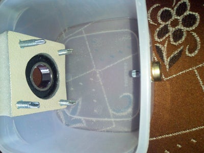

After
that I installed it inside the ice-cream box and secured it with the 4 screws and cut the appropriate hole through the inner race of the bearing with the help of drill, knife and emery paper.

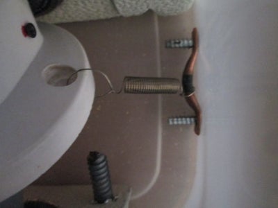

Step 8: Steering Gear Box Assembly
Now

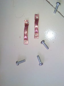

prepare two holders from the copper pipe by flattening them from the end and giving a curve in the middle portion
now make two holes at the ends same size of the screw which
u will be using and then drill the holes in the box too and screw the holder along with the rubber bands make sure that the two screws on the bulb holder are not tight since it will be done after alignment off bearing 1, bearing 2 n potentiometer.
I replaced the rubber bands with springs since they get wear out within two days of playing.

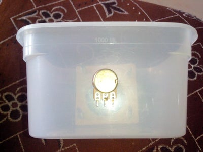

Step 9: Finding the Center Position of Potentiometer.
Now
install the second bearing also and at the end of pvc pipe put a cap which is drilled and holding the potentiometer knob tightly the pot has a movement of 270 degrees so divide it by 2 n make sure that the pot is in middle position which u can also do by multi meter .

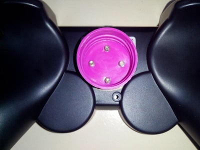

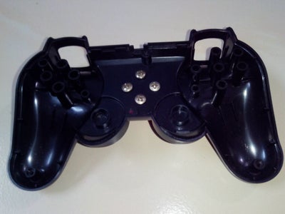

Step 10: Drill & Screw the Cap to Game Pad
Back side of the game pad is attached to the cap with four screws .

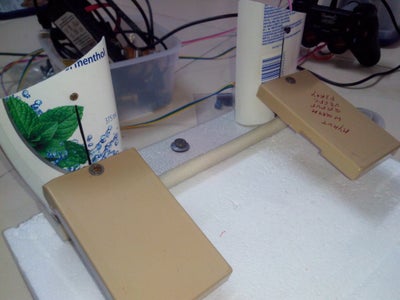

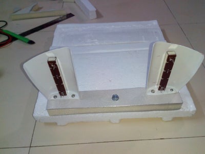

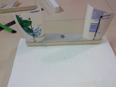

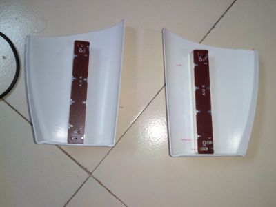

Step 11: Sliding Pot.
Now for making accelerator n brake paddles I used a shampoo
bottle cut into two pieces symmetrically and attached sliding potentiometer of 10 k.
again here I have used a rectangle shaped PIR panel sheet which is screwed to a normal Styrofoam of white colour I cut out from my TV packaging. In this way I have prepared platform for brakes n accelerator

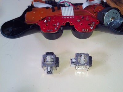

Step 12: Testing

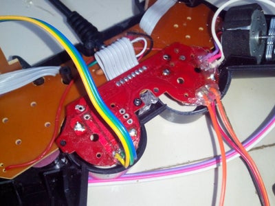

Testing of all the function by gamepad
for connecting brakes , accelerator and steering i removed both the potentiometer from the game pad and connected sets of 3 wire of which one is going to brake another is going to accelerator n last one is going for steering so in this way out of 4 connection 3 are utilized during testing i found that the axis in the X360 controller simulator is not in center since one connection was empty so i removed one potentiometer from the analog stick and soldered it to its desired place and after that everything works fine .

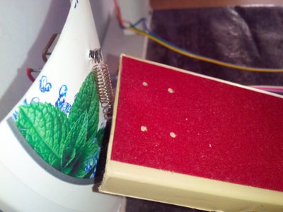

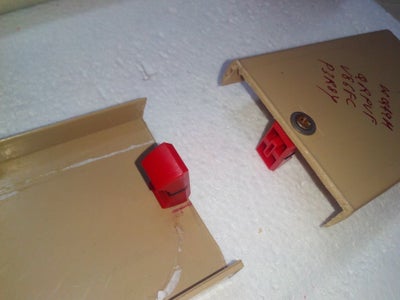

Step 13: Paddle for Brake & Accelerator
Next step was to make paddles for brakes and accelerator for which i used a jewelry box tear it into two pieces and the cut it from the middle with the help of soldering machine .CAUTION don't inhale fumes while burning (shaping plastic to ur desired design ).after soldering i have done filling over the edges to give it a smooth finish and then screwed it to the knob which is red in color. this knob comes with the potentiometer .after screwing i stick red velvet sheet on it .

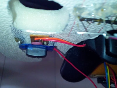

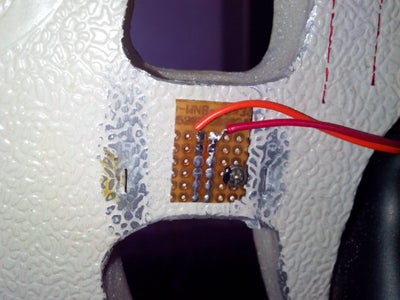

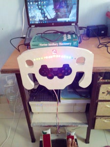

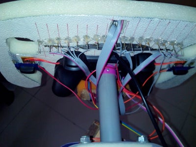

Step 14: Electronic Assembly
Electronic parts
to give it a nice visual effect and appearance i decided to add gear display and rpm indicator for which i have used ATmega 32A IC .the connections are explained below
led 1 to 16 (positive terminal ) are connected to port D and C with resistance of 100 ohm and their ground is connected to the pin 11 of micro controller
seven segment display is connected to port b from 1 to 8 pin excluding vcc where vcc is connected to pin 10 of micro controller
rotary(steering) potentiometer pin no. 2 is connected to pin 39 of micro controller and pin no. 1, 2 and 3 are connected to the game pad pcb . (pin no. 2 has two connection)
and gear shifter T1 and T2 are connected to pin 36 and 35 of microcontroller

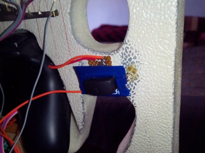

here one connection is for seven segment display and other that is button is for game function, when this button is pressed both the function will occur simultaneously.
since the PIR panel sheet material i have used is covered with thin aluminium foil on which screw is connected to GND.
