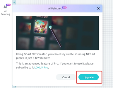

The Idea Studio actually has 50,000 + free SVGs and a free AI feature. To unlock the AI feature (for free), all you need to do is to click on "Upgrade". You can create 20 designs for free.
