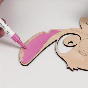

Step 3: Painting and Assembling

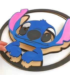

Once cut, gently sand any rough edges on the plywood pieces for a polished look. Paint the layers prior to assembly to avoid smudges. Use acrylic paints to bring Stitch to life: apply blue shades for his body, black for outlines nose and eyes, pink for the inner ears. Let everything dry completely for vibrant, even colors.
Paste in order, then paste the other components, and finally paste it at the back, then place the light strip at the bend below.
Step 4: Enjoy Your Work!
Mount your assembled Stitch wall lamp on the wall using the hardware, plug in or turn on the LEDs, and watch the character come alive with soft, enchanting light.
