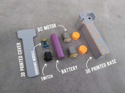

  1. 3.7v Rechargeable Battery
  2. TP4056 Charging Module
  3. ON/OFF SPST Switch
  4. 130 Micro Toy Motor

For 3D Printing, You can directly download the required STL files below:
  1. Housing.stl
  2. Cover.stl
  3. Wheel.stl

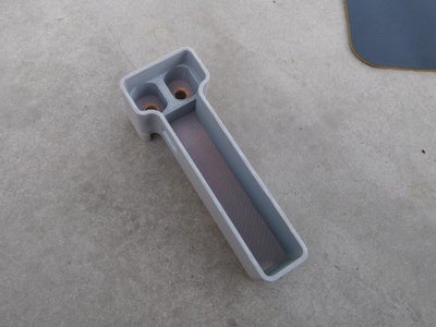

Step 2: Motor Assembly

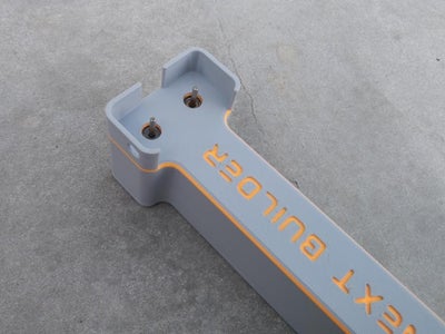

After getting the 3D printed parts, I started with assembling the DC toy motors. Place both motors into their slots on the base. They should fit perfectly in the spaces designed for them. Once placed, apply a small amount of super glue to hold them in position. Make sure not to get glue on the motor shafts, as that can stop them from spinning. Let the glue dry properly before moving on.

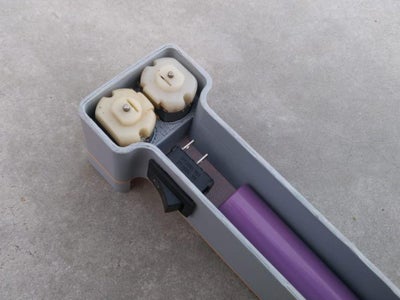

Step 3: Charging Module Assembly
Once the motors are securely in place, it's time to Secure the TP4056 charging module. Locate the dedicated slot for the module on the base. On the back side, you’ll see a cutout perfectly shaped for the Type-C port. Carefully align the port with the cutout so it fits nicely. Once aligned, use a small amount of super glue to fix the module in place. Make sure the port is straight and accessible from the outside. Let the glue dry completely before moving on.
Step 4: Switch Assembly
Next, install the ON/OFF SPST rocker switch into its dedicated slot on the body. Simply align the switch with the cutout and gently press it into place. The slot is designed to hold the switch tightly, so it should snap in and stay firm without any extra support.
Step 5: Connection
The connections in this project are pretty simple and easy to follow. Take a look at the connection diagram above to see how everything is connected. You’ll need to connect the motors, the TP4056 charging module, battery, and the rocker switch together.
Start by connecting the motors in parallel, then connect them to the switch. The switch will go between the battery output and the motors, so you can turn the device ON and OFF. The TP4056 module will be connected to the battery and also handle the charging through the Type-C port. Make sure to solder the wires properly or use tight connectors, and keep the connections neat.

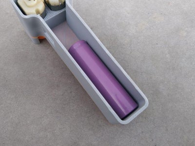

Step 6: Battery Assembly
After completing all the wiring, it's time to attach the battery. While there’s no fixed slot for the battery, there is an empty space in the design where the battery fits nicely. Place the battery in that area, making sure it doesn’t block any moving parts or wires.
To secure it, you can use a hot glue gun or double-sided tape—whichever is easier for you. Make sure the battery is firmly attached and doesn’t move around when the shooter is in use.

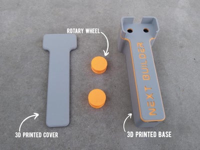

Step 8: Rotary Wheel Assembly

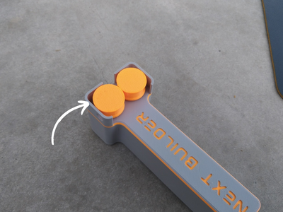

Now it’s time to add the main part — the rotary wheels. Each wheel has a small hole that fits perfectly on the DC motor shaft. Just line up the hole with the motor shaft and gently press it in. It should fit tightly and stay in place. Do the same for both wheels. Make sure they can spin freely and are not loose.

Now it’s time to make the string for the shooter. Take a piece of yarn 🧶 — the same type that’s often used for knitting sweaters. It’s easy to find and works great for this project. Cut about 1.5 to 2 meters of yarn.
Pass one end of the yarn through the hole on the right side, then thread it through the rotary wheels. After that, bring both ends together and stick them using a small amount of super glue. Let the glue dry properly so the string forms a strong loop.

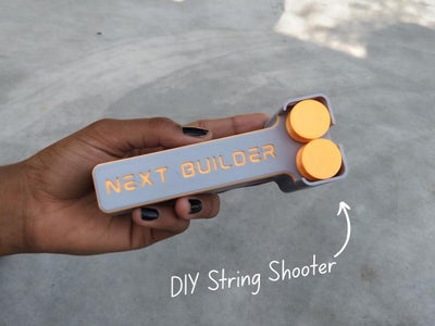

Step 10: Testing
Now it’s time to test your DIY String Shooter! First, make sure the battery is fully charged using the Type-C port. A full battery helps the motors run smoothly and gives the best performance.
Once charged, press the ON switch. The rotary wheels will start spinning fast, and your string will shoot into the air. It’s really fun to watch it work!
In my case, I used a rope instead of yarn because yarn wasn’t available. It still works, but for the best results, I recommend using yarn or a soft, flexible thread. That way, the string moves better and flies more easily through the air. Try testing it a few times and experiment with different - different string lengths or materials to see what works best.
Now your string shooter is ready—have fun and enjoy!
