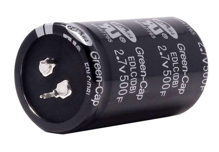

Step 18: Adding Supercapacitors
The current design worked flawlessly, but I still wanted to make a few minor tweaks for an alternate design. The main one being the removal of regular non-rechargeable batteries for rechargeable supercapacitors. I wanted to try supercapacitors instead of regular lithium based rechargeable batteries because they have a few advantages :
  1. The can provide heaps of current
  2. They can't be over discharged
  3. They don't require complex charging circuits that precisely regulate current flow and voltage
However they do have a few disadvantages over regular lithium ion batteries
  1. They lose their charge rather quickly
  2. Their capacity (measured in Farads) is much lower than lithium ion batteries
  3. They usually only have a voltage of 2.7V and can be charged to around 2.5V
For these reasons I bought a 500F 2.7V capacitor
Step 19: Testing the Supercapacitor
Firstly I wanted to get a feel for supercapacitors and decided to run some tests. I noticed that their change storage is way less permanent than with lithium batteries and decided to graph this loss of electric charge first. To do this I charged the capacitor to 2.5V and let is slowly discharge to the environment. I regularly checked the voltage and was pleasantly surprised to find a nice graph showing the exponential decay of the voltage in the supercapacitor. Next I tested the amount of amps drawn by the supercapacitor when charging from two AA batteries. This also showed an exponential decay graph, but this time it was not as pronounced. And so with a rough feeling of supercapacitors, I started designing.
