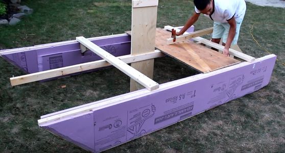

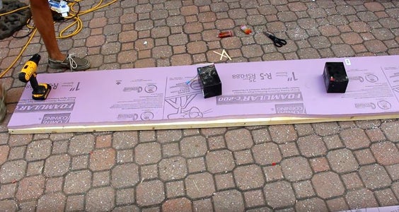

The catamaran will be composed of 2 pontoons. These pontoons will have a frame filled with the white, less durable Styrofoam in the center; then we will later add the pink Styrofoam to the outside.
To start off i lay out two 2x2 pieces of wood with the white Styrofoam pieces in the center. This will be the inside of the pontoon. Next i add a front triangle onto the pontoon. As you can see in the third picture i added 2 struts near either end of the pontoon. Once that is finished i fill the pontoon with white Styrofoam and cut it to fit in the gaps.
Step 3: Finishing the Pontoon

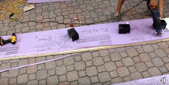

to finish off the pontoons we must first cut 4 pieces of Styrofoam to size (2 for each pontoon). To cut them all at once i clam them together and use a reciprocating saw to cut the height from 2 feet to 17 inches (the height of the pontoon).
After that i use 1 - 1.5 tubes of epoxy as adhesive. I spread the epoxy on the wooden frame and then lay the Styrofoam down onto the wooden frame and add weight to it so the Styrofoam stays tight to the frame as the epoxy hardens. After that i use the saw to taper the bottom edge. I also add Styrofoam to the front triangle and taper that as well. Once complete you should go ahead and do that for both pontoons.
Note: The strut layout in the second pic is different then the layout of the of the struts in the previous page. The layout in the previous page showed the correct positioning of the struts.
Step 4: Completing the Pontoons
Now you can see both pontoons side by side. To complete them i add a wooden triangle positioned at the top, and lined up with each strut, this will be used for mounting the frame. To add some more buoyancy i also cut a full 2' x 8' piece of Styrofoam in half lengthwise (giving us two 1' x 8' pieces). I use epoxy to mount those onto the inside of the pontoons.
Now both pontoons combined give a buoyancy of 460 lbs when fully submerged. This seems like a lot but when you consider you wouldn't want more then 60 percent of the pontoon submerged (then you would be uncomfortably close to the water) and you might also have you weight towards one side of the pontoon then it seems this 460 lbs is just enough for one person to float comfortably. (i fit 2 full size people on but it sits very low). If you wish to be able to make this a 2 person boat you can add more Styrofoam sheets to the outside. Each 1"x 2' x 8' sheet once cut to a height of 17" provides 62 lbs of buoyancy when fully submerged.

To make the frame i cut my 2x4 s to 4.75 feet long and attached them to the pontoons using screws. I chose that width because it was just small enough that i would be able to fit the frame (when separated from pontoons) in the back of my van. Next i add the 2x3 piece down the middle of the boat. This is both for structure and to mount other parts off of.
