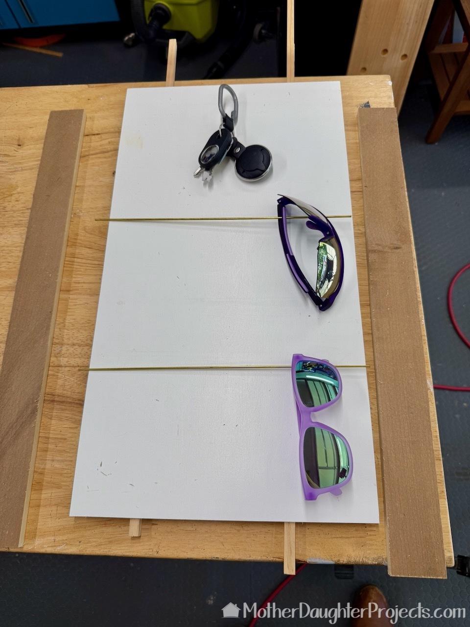

We first cut the pallet board in half lengthwise so we could set them up to determine the width we needed as well as the length by putting the keys and sunglasses into place.
Once the width and length were determined we cut the back board to size as well as the boards for the sides.

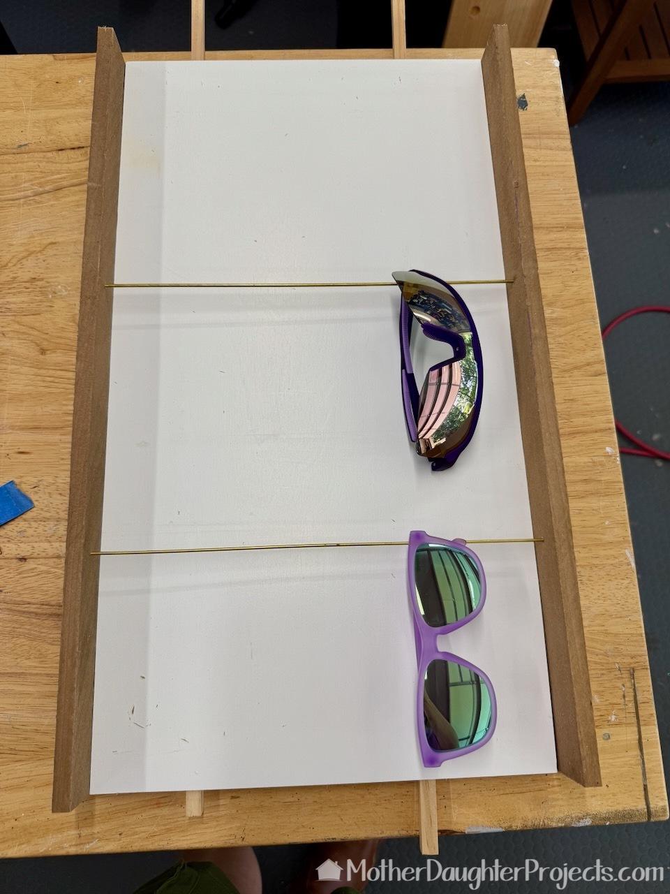

Step 3: Add Rods
To hang the key/sunglass holder we will be using a French cleat. We are insetting the backboard about three quarters of an inch using square dowels so that the unit will sit flat against the wall. If we didn't do this then the unit would stick out from the wall and not lay flat.
We determined the placement of the rods by putting the sunglasses and keys into place. Once this was done, we marked the placement of the rods on each side of the sides. You could also use wood dowels in place of the metal rods.

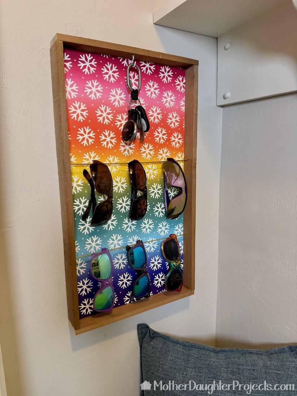

When I made the original key holder, I used a piece of wrapping paper as the background. We decided to do the same with this new enlarged version. We sprayed the board with spray adhesive and then laid the board on top of the wrapping paper to adhere and then carefully cut off the excess.
We added a cup hook to the center of the top to hold keys.
To assemble, we used wood glue along all the edges of the backboard, clamped the sides and let it cure for 24 hours.
Because the back piece is so thin we were unable to screw the French cleat into place so we used contact adhesive which worked very well.
Step 5: Install Into Place
Here's the original key holder. It served well for over a decade! With the wall portion of the French cleat attached, it was time to hang the new holder. Here it is in place. You can see the entire landing zone with the bench in the next picture.
It's a happy pop of color that makes us smile as we pass by. Keys and sunglasses are conveniently located and ready to grab as Steph heads out the door to her outdoor adventures.
