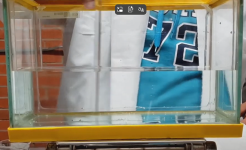

Step 1: Fill the Tank
Fill the container with a liter of water to a height that exceeds the width of the lantern since the light must pass through the liquid.

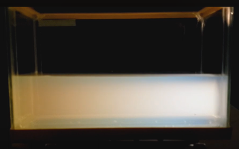

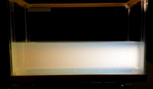

Step 2: Adding Milk
Using the syringe, we pour a few milliliters of milk into the tank. Then, using a spoon, we mix until the mixture is uniform.
At first glance, it is clear that the liquid in the tank has turned white due to the addition of milk. At this point, light arriving and passing through this medium interacts with the molecules in the solution.

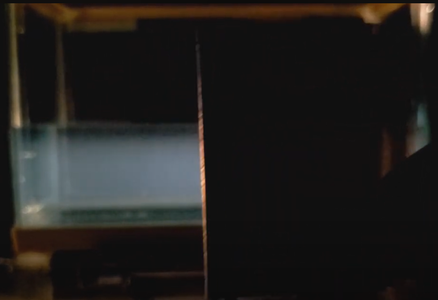

Step 3: Polarization
We place the polarizer in front of the tank. By rotating it, we observe whether the object lets light pass through or blocks it. This is because the molecules inside the liquid change the polarization of the light that reaches them.

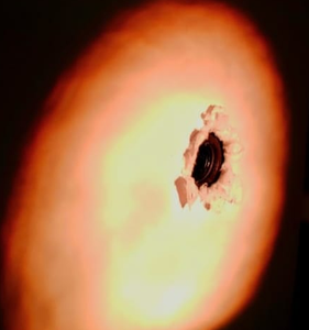

Step 4: Sunset

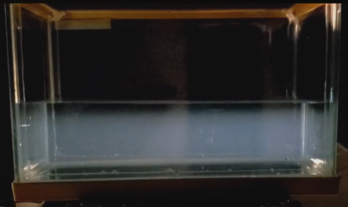

We position the flashlight at one end of the tank so that the emitted light passes through the aqueous medium and crosses it entirely until it reaches the white paper placed at the other end, which functions as a screen.
We can observe that the light entering the fish tank has a bluish-white hue. As it moves further into the medium, however, the light becomes orange.
When we look at the screen, we see an image reminiscent of a sunset.
