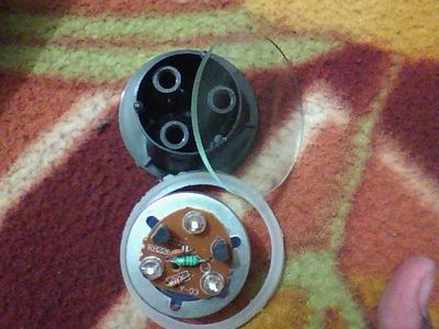

If you have got an old torch just like us...open it and take out the light bulb or leds out of it...
And remove the old slide switch from it...
And don't forget to remove the cells...

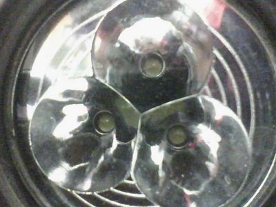

Now take the 1w LEDs and put them on the reflector and adjust them according to the circuit...

Cut out a piece of PCB or Cardboard and put the slide switch and push button on it and fit it in the space where the Torch's old switch was...
Check that all the LEDs glow when you join them with the battery...
