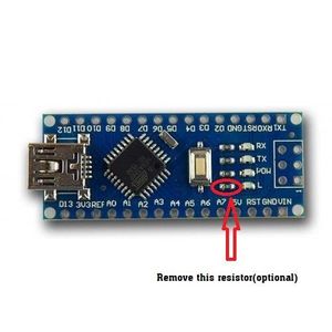

According to some instructions, the LED resistor on pin13 from Arduino should be removed (this resistor is circled in red in the picture), but in my case, the device worked without any modifications to the microcontroller. The instrument works stable with only one 3.7 Volt lithium battery.
