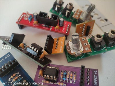

In this Instructables I will show you how I managed to realize some Eurorack modules made of six main building blocks:
  1. Front block
  2. Power filtering block
  3. Passive Attenuation block
  4. Inverting amplifier block
  5. DC bias block
  6. Phase shift block

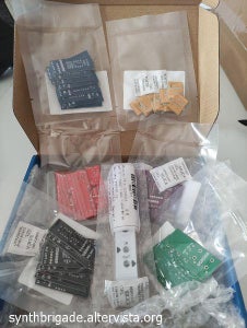

I will share with you Gerber files to have all the PCBs manufactured and dramatically speed up the building process, if you are interested (lazy butted brigade to the rescue!).

A full module will ask for at least four of the previous circuits and a faceplate.

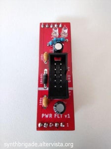

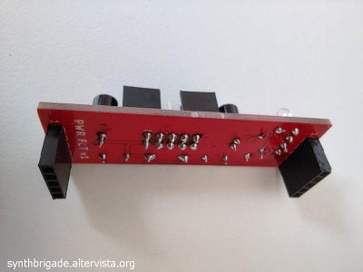

Power Filter
The power filtering circuit is very simple. Four capacitors in total, two electrolitic and two non polarized, are in charge to filter high and low frequency noise from the PSU +/-12V lines.
A diode with the cathode pointing the +12V and anode to -12V assures module's inversion polarity protection.
Two LEDs are there to monitor voltages from the PSU. These (and their current limiting resistors) are optional if you already have a power indication somewhere in your synthesizer and want to save some mA.
The PCB hosts a 5x2 pin IDC connector with Eurorack pinout for power supply.

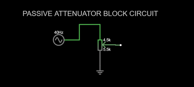

Passive Attenuator
By Learning Modular definition, "an attenuator is a device that reduces (or "attenuates") the level of a signal. A fader on a mixer is an attenuator. Attenuators are particularly useful for adjusting how much "depth" of modulation you send from one module to another module's parameter – for example, whether an LFO makes the pitch of a VCO go up and down a lot (the result with no attenuation) or a little (the result of attenuating the LFO's signal)".
The simplest circuit we can adopt for the task is a so called "voltage divider".
By Sparkfun definition, "A voltage divider is a simple circuit which turns a large voltage into a smaller one. Using just two series resistors and an input voltage, we can create an output voltage that is a fraction of the input. Voltage dividers are one of the most fundamental circuits in electronics".
A voltage divider in it's simplest form is made up of two resistors, but this way you have a fixed voltage division. We want a continuous variable voltage out of the circuit, so we use a potentiometer.
Voltage dividers are often already takeing care of the input voltage level in most modules. When this is not the case, an attenuator module comes to the rescue.
Please notice: a voltage divider is NOT a circuit capable of delivering high currents. It is perfect for control voltages, but it cannot be used as a step-down voltage source.
This block is the simplest of the lot and rely heavily on the front block main component: the potentiometer.
>>HERE<< is a simulation of this very simple circuit.

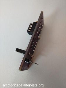

Step 3: Blocks Layout
On my previous modules I used a flag-like geometry, with the PCB mounted perpendicular to the faceplate. This is the simplest and less prone to errors way to lay down a circuit and I prefer it over the parallel approach of most commercial modules.
The issue with flag-mounting is that it calls for modules at least 6HP wide, or the thickness of the populated PCB will be impossible to host whithin the panel lateral dimensions.
In this very special project case, blocks circuits are simple, and would not justify the use of a panel wider than 4HP. In addition, the building block appoach of the project calls for stacked PCBs, so I ended adopting the parallel mounting approach.
Blocks can be divided into 3 main categories:
  1. Front blocks
  2. Main circuits blocks
  3. Auxiliary blocks

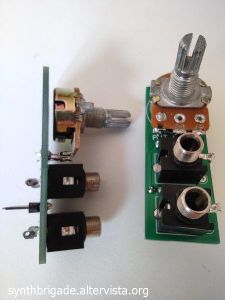

Front blocks are intended to be locked beneath the face plate and host the user interface components (potentiometers, jacks, LEDs, etc. etc.). At the moment there 's only one type of front block, but more are in the line.
The 4HP faceplate can host two front blocks in a row.
Main circuits blocks host the active (or passive) signal modification circuit. They are intended to be directly connected to front blocks.
Auxiliary blocks are circuits that perform an auxiliary function, like filtering the power supply, hosting additional connectors, etc. etc. The power filter block is the only aux block available at the moment.
A full 4HP "modular module" is made of two block stacks in a 4HP space.
One stack output must be connected to the other stack input if a series modulation is required.
Components used are the most common available.
The 1/8" signal jacks are everywhere online and cheap, so it is not difficult to source them - I hate when a project realization has to be put on-hold by components shortage or "for manufacturers-only" minimum orders. Signal jacks I used are commonly labelled PJ301M.
Even the potentiometers are common linear (or logaritmic) pots I bent and "elongated" with some single pole conductor in order to reach the PCB holes. These are commonly labelled WH148.
