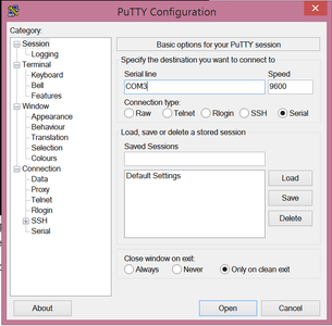

There are wonderful resources on understanding serial ports. Here is the basic overview. A serial port is a simple way to talk to a microcontroller with a computer. We use this to tell the servos what they are supposed to do. To test our serial port and our servos I use putty. This is normally used for network communications, but since windows removed hyperterminal I have reverted to putty. If you are using linux, I like gtkterm, it feels a lot like putty. From this point I will use putty. Before opening putty you have to figure out which port your VSP is plugged into. Simply open a command prompt by typing "cmd" into any of windows many search options. Then type "mode" in the command window. It should display something that looks like the terminal window shown. Notice that this one reports back "COM3" but yours may display many. I simply unplug it and see which one disappears and then reappears when I plug it back in.
Now open Putty. Select the "Serial" radio button and modify it to the correct port. I did use a baud rate of 9600 as well. This is specific to the code for the microcontroller so don't change that. Once open type the following:
#10010&
This should move both servos opposite directions. The commands that I set up are as follows
First character needs to be #
Second character is 0-4 (0-stop 1-Forward 2-Left 3-Right 4-reverse)
3rd through 7th character is the time duration that the wheels will be moving.
8th character is & and denotes the end of the string. If you type something wrong simply place a & and start over.
You should now have a computer controlling servos.

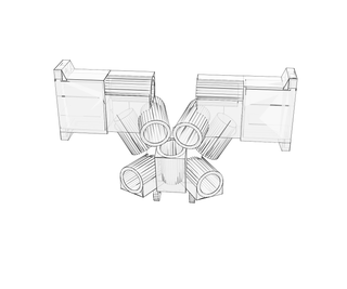

I decided to 3D Print my Chassis. I've attached my *.stl for the three body parts the drag wheel and the wheels.
I used standard electrical conduit in about 10" sections to tie everything together. The conduit is only about $4 for a 10' section at your local hardware store.
I used hot glue to hold it together. The servos should simply snap into the blocks there.
I left the platform up to you. There are three post holes at 15 degrees out of the 3D printed chassis mounts. You can just use one or two of these, or all three for a tripod and a platform. Just be careful because the servos are pretty small for this build. I recommend if you want something more solid to look into another chassis. PWM output is very standard to most motor controls especially in the RC arena, so you can simply find a robust tank chassis and you are off.
