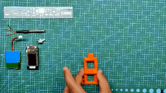

These are the materials that were used in this built-
  • TTGO T DISPLAY
  • DS18B20 Sensor
  • 3D Printed Parts
  • ON OFF SWITCH
  • LiPo Cell
  • Breadboard and jumper wires

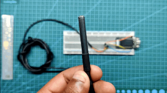

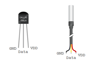

Step 2: DS18B20 Sensor
The DS18B20 digital thermometer provides 9-bit to 12-bit Celsius temperature measurements and has an alarm function with nonvolatile user-programmable upper and lower trigger points.
The DS18B20 communicates over a 1-Wire bus that by definition requires only one data line (and ground) for communication with a central microcontroller.
This sensor comes in two form factors, one that looks like a transistor and a probe-like device that we'll be using in this build.
Check out its datasheet for more info about the sensor itself.

Step 4: BREADBOARD SETUP
Before starting the Assembly process, we first have to prepare a breadboard setup for testing and setting up the libraries that we require.
First, we connect TTGO Board with DS18B20 Sensor by using the attached wiring diagram.
  • Vcc of Temp Sensor to 3V of TTGO
  • GND to GND
  • we add a 10k resistor between 3V and Sensor Pin
  • Sensor Pin to GPIO2

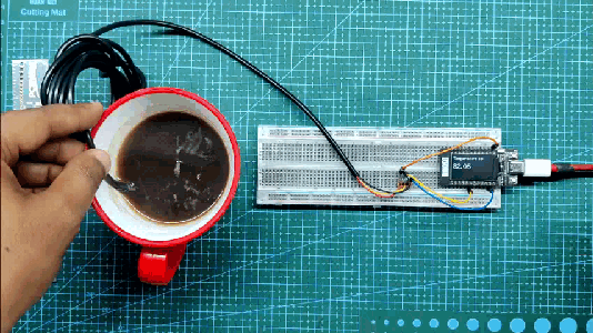

Step 6: TESTING
After Uploading the sketch, we test this Temperature Sensor setup by using two mediums like ICE and HOT Coffee.
ICE is for testing low temperatures and HOT Coffee is for testing high temperatures.

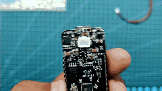

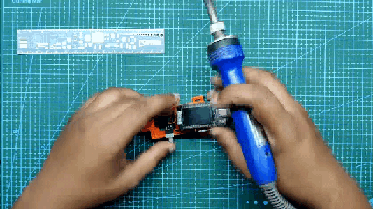

Step 7: ADDING BATTERY to TTGO

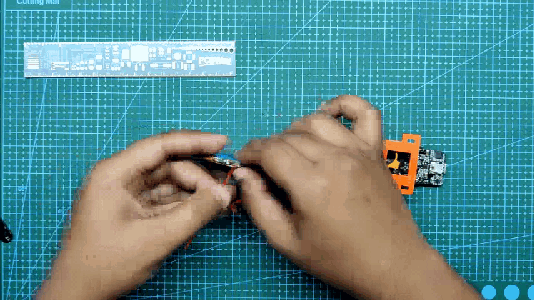

TTGO Board has an onboard Lithium Cell charging setup, we can add the Lipo Cell to power the board.
It comes with a small JST Connector but I lost that wire harness so I used a slightly bigger wire harness and its JST connector.
  • We add the JST connector on the existing one's Positive and negative port with soldering iron.
  • Next, we add a lithium cell to its JST connector and test if the TTGO Board is working or not.
After this, we can now finally prepare the 3D Body for final assembly.

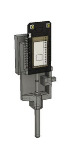

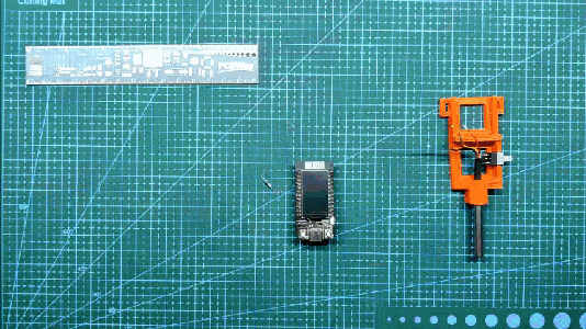

Step 8: 3D PRINTED PART
3D Body is basically an Exoskeleton that holds the sensor, TTGO Board, and battery altogether, it doesnt cover anything so that's why it's like an Exoskeleton.
This model was designed in Fusion360 and then exported out as a mesh file for 3D Printing. The files are all attached.
We use Orange PLA with a 1mm Nozzle and 0.32mm Layer height for preparing the 3D Printed part. 1mm Nozzle gives the body structural strength.

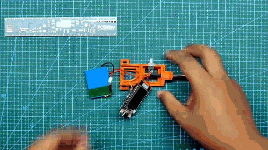

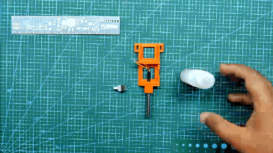

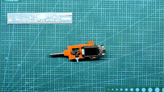

Step 9: MAIN ASSEMBLY

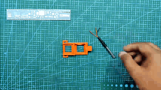

  • Next, we start the final assembly by first adding the DS18B20 Sensor to the 3D Printed body.
  • We then add a Switch to the 3D Body by using a few drops of super glue.
  • Next, we add the 10K Resistor to GIPO2 and 3V Pin, we also connect the TTGO's 3V and GND to DS18B20 Sensor.
  • We add DS18B20's sensor pin to GPIO2
  • Next, we add the switch in between LiPo Cell's Positive terminal and wire harness so we can use the switch to disconnect the battery from TTGO Board as the TTGO Board doesnt have an ON-OFF SWITCH for disconnecting the power source.
  • We connect the Battery to its JST connector and test the switch connectivity.
  • Next, we add Hot glue to secure the battery and TTGO Board in their place.
  • And the setup is now completed.

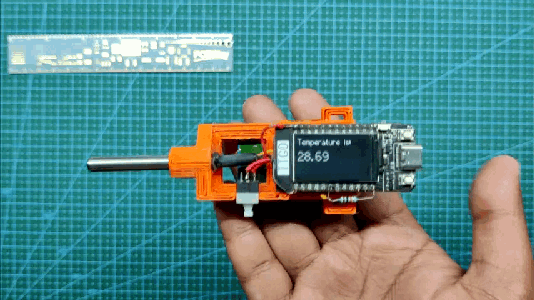

Step 10: RESULT
Here's the result of this built, a working Thermometer that measures accurate temperature hot or cold.
For the main test of this device, I use it to measure my body temperature.
It took a whole minute to take readings to get stable but the end reading was 35°C which is the normal Body Temp.
