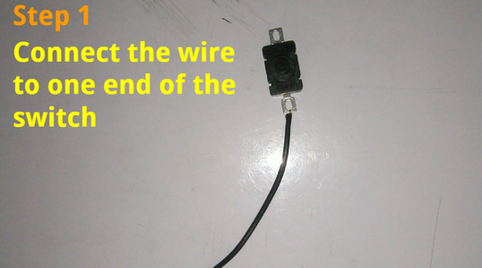

Step 3: Connect a Wire and a on / Off Switch
Step 1: Connect a wire to the one end of the on / off switch
You can get a small on/off switch in any electrical shop near you. Make sure that the wire is connected securely to the switch and does not come off easily.

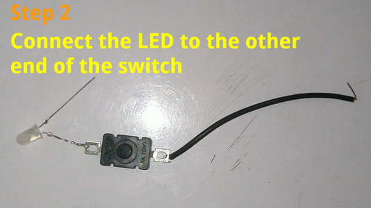

Step 4: Connect a LED and a Switch
Step 2: Connect a led to other end of the switch
A LED has two legs and usually the longer led is positive terminal and shorter one is negative terminal. However it may be different in your case. So, you have to test the terminal using a battery and a resistor before connecting it. Please do not connect the two terminal of LED to the battery, use a resistor [270 ohm], otherwise you might damage the led and burn your finger.

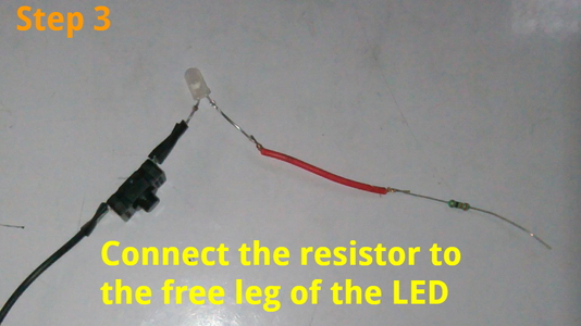

Step 5: Connect a Resistor to a LED
Step 3: Connect a resistor to the other leg of the LED
Always remember to connect a resistor while lighting a LED. The resistor limits the flow of current from battery so that the LED is protected and glow for long time.

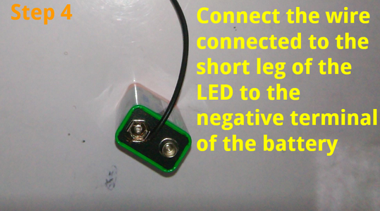

Step 6: Connect -ve Terminal of LED and -ve Terminal of Battery
Step 4: Connect the wire connected to the shorter leg of LED to the negative terminal of battery.
Make sure that the positive terminal of LED is connected to positive terminal of battery and negative terminal of LED to negative terminal of battery.

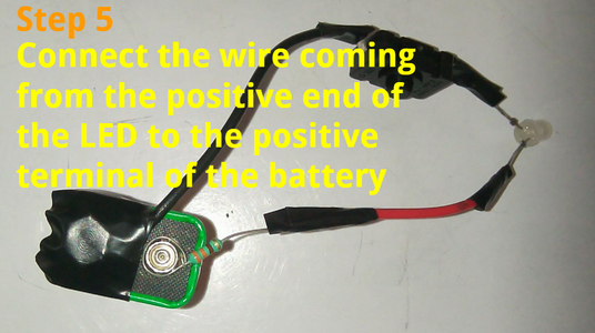

Step 7: Connect +ve Terminal LED and +ve Terminal Battery
Step 5: Connect the wire coming from the longer leg of LED to the positive terminal of battery.
Check the connection of LED and battery. Make sure that switch is between the LED and battery.

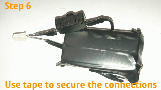

Step 8: Secure the Connections
Step 6: Secure the connection using an electric tape.
Be careful to make the connection secure among wire, resistor, LED, switch and battery.
