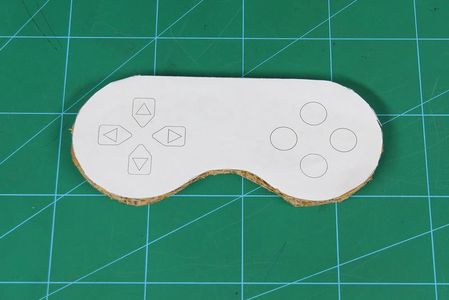

Step 2: Designing the Controller
The controller will have the following design. You can save this image and take the print out. Or you can make one as you wish to.
- Once you have the design on paper, take its cutout.
- Take the cardboard and cut it in the shape of the Controller with the help of the paper cutout.
Thus the base of the Controller is now ready. - Stick the paper cutout on top of the cardboard cutout.
- Now, one of the most important parts, coloring with the Conductive Ink or Electric Paint.
We will next paint the buttons which we are going to use using electric paint. - We will now cover the remaining Controller using the normal water paint.
