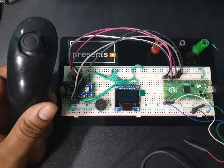

For this circuit, I used a thin foil of aluminum as a touchpad which can be used as a remote button. For this remote circuit, I used five touchpads
- a volume up,
- a channel up,
- a volume down,
- a channel down
- and an on/off switch
and IR LED is used to transmit the data to the television an LED to indicate the presence of data transmission and some jumper cables connect the Arduino and the breadboard.
Now let me show you the buttons which have been made, I had folded the aluminum foil in the shape of a rectangle and each button is connected using wire, each pad is connected to Arduino's input and whenever I press each button the data corresponding to that switch will be sent through the IR transmitter.
As you can see the LED blinks at the delay rate of 40ms and whenever we pressed the button the LED blinks by the hex value which I have implemented from the remote. Alright, let me show you the remote circuit. Here, for this project, I used a sony remote. I used the decoding algorithm to map the buttons volume up, volume down, channel up, channel down, and on a touchpad and I implemented the code in the Arduino.
I have given the inputs applied to the Arduino from the PC using and micro USB cable whenever I press any button, I can see serial data on my monitor. The change of channel or increase or decrease of the volume can be seen at the bottom of the TV screen.
