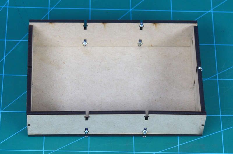

Step 3: Making of the Base Box
We have laser cut the MDF sheets with the following dimensions. You can use either thick cardboard or even add layers of cardboard for stability.
- Take the base plate and attach the side plates with the help of M3 bolts of 12 mm length and M3 nuts.
- Take the Upper Plate and in the holes made, insert the Bulb holder.

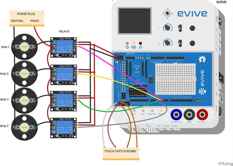

Step 4: Interfacing the Relay
- Take the Electric wire and cut it in small parts.
- Take the relays and similar small 8 electric wire pieces.
- Connect them to the COM terminals and Normally OPEN terminals of each relay.
- Attach 4 relays on the upper plate using a glue gun.
- Then, take the wire connected to the Normally OPEN to corresponding to each bulb holder’s one of the terminals of the bulb.
- Take the wire connected to the COM terminal and connect it together and finally connect it to the remaining terminal of the plug.
- Take the 4 such pieces and attach each one to them to each terminal of the bulb holder.
- Next, connect all these 4 wires to one and connect them it to one of the terminals of the plug.
- Connect the jumper cables to the VCC, GND and SIGNAL terminals of the relays.
- Connect all the VCC in one and GND in another.

Step 7: Circuit Diagram
The pins are connected as follows:
- VCC – 5V on evive
- GND – GND on evive
- SIGNAL – Digital Pins (2, 3, 4, 5)
