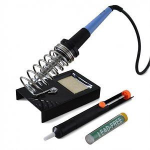

In this list you will find everything you need for the project:
* Arduino Leonardo
* Braidboard
* Flat mini-usb cable to connect the Leonardo to an usb-port
* Flat standard telephone cable
* 10k-resistors (3)
* 6x6x6 mm standart arduino pushbuttons (3)
* 1mm arduino cables
* Soldering iron
* Textile rubber band
* 2-component silicone
The box and Transcribe Controller are 3D-printed, because of the needed precision for the pushbuttons. The files are delivered in this Instructable. As are the Arduino codes.
