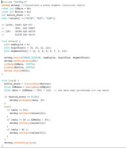

Step 3: Programming the Code
The code is shown above. When everything is set-up correctly, you need to calibrate your sensor. This is because of the background light. We used tap-water for our null-point and tap-water with coffee creamer powder as the highest level of turbidity possible.
Also, the seven segment 4 digit display is optional. For the display to work, we used the library SevSeg. For more info, visit https://www.arduino.cc/reference/en/libraries/sevseg/
