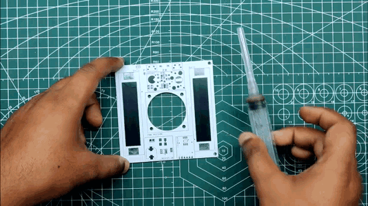

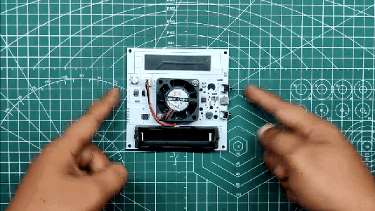

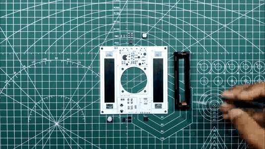

For this project, I'm using a PCB from one of my previous project. It has an onboard power source and an Attiny13A that uses a Mosfet IC to control a load.
The electronics are all housed on the bottom side of the Fume Extractor Project, leaving the top side clear.
One justification for selecting this PCB was that it already had a setup for operating a DC motor that worked without modification. It consists of an N channel Mosfet IC-AO4406 linked to an Attiny13A AVR MCU.

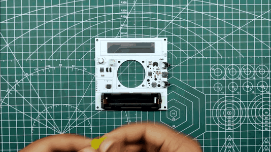

Fume extractor PCB is being used in this project. I have already prepared an article about the assembly of this board, but let's revisit the whole construction process of this board.
  • We first apply Solder Paste to each component pad by using a solder dispensing syringe.
  • Next, we pick and place all the components in their location by using an ESD Tweezer.

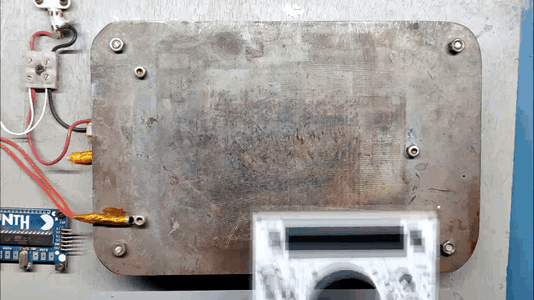

  • we carefully lifted the whole circuit board and place it on the Reflow Hotplate for soldering, After a few mins when the hotplate reaches the Solderpaste melting TEMP, all the components will get soldered by this Hot Reflow process.
  • Next, we place the remaining components in their place which are Vertical switches, USB ports, and a JST connector for the FAN, and use a Soldering Iron for soldering them.
  • Board is now completed.

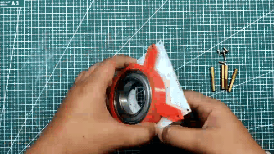

Step 7: Bearing Part Assembly

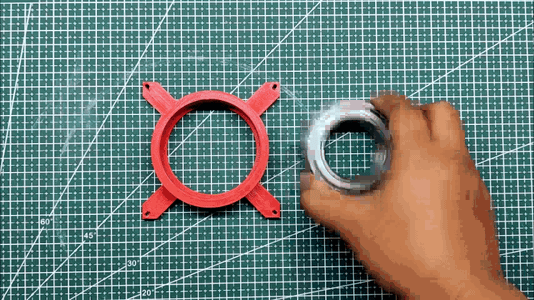

  • In order to begin the assembly procedure, we first insert the main bearing into the 3D-printed bearing holding portion. The bearing is simply inserted into the center and pushed into position with a small amount of force.

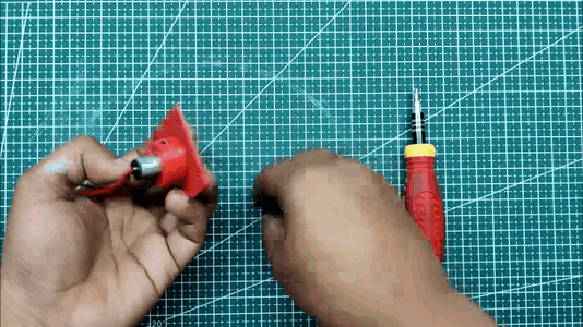

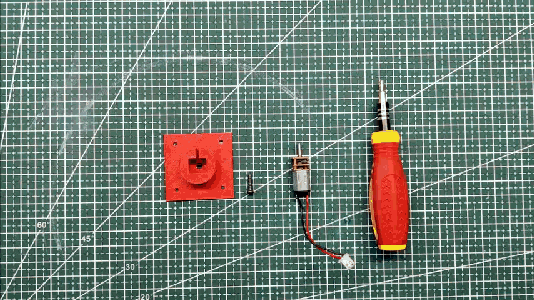

Step 8: Motor Holder Assembly
  • Next, we add the gear DC motor into the 3D Printed Motor Holder Part and then use an M2 Screw to tighten the Motor Holder part.

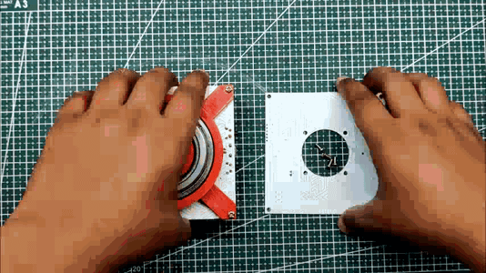

Step 9: Adding Bearing Assembly With Main PCB
  • The Bearing Assembly is now added to the Main PCB using four M3 screws and four PCB Standoffs on the board's bottom side.
  • Using four M3 screws, we then attach the Motor Holder Assembly to the board's bottom side.
Step 10: Adding Motor Dock With the Gear Motor
  • We attach the Motor Dock to the gear motor shafts after attaching the Motor Holder and Bearing assembly.
  • The JST connectors from the Board and Motor are then connected.

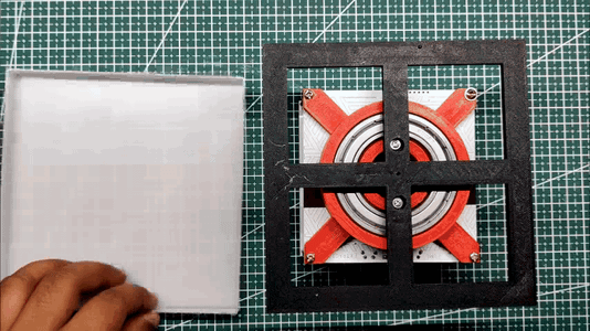

Step 11: Finishing the Assembly

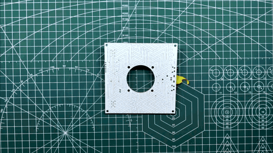

  • Finally, using four M3 screws, we attach a second Fume Extractor PCB to the PCB Standoffs on the bottom side.
  • The build is finished after attaching the Turntable Part to the Motor Dock using two M2 screws.
  • We add a cover to the turntable holder as the last touch to improve the aesthetics and add items.

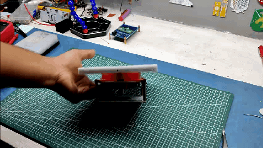

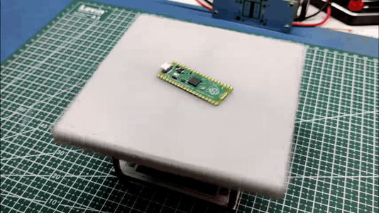

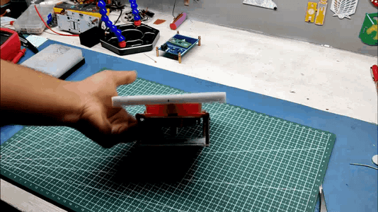

Step 12: Result

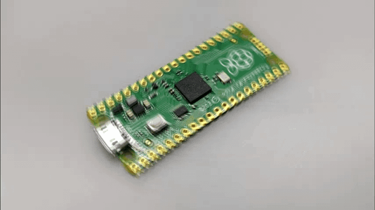

Here is what this build created: a revolving Turntable that can be used to record rotational films of XYZ objects. Like the Raspberry Pi Pico on the Turntable, which I shot briefly.
A lower or higher PWM value can be used in the code to control the turntable's rotation, which was set at 20%.

Overall, I'm pretty happy with the result. It works, and I'll use it to record rotational videos of small components for upcoming projects.
