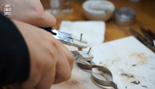

Step 4: Ring 1: Make It Into Twisted Twist
With the pliers to make soft silver sticks twisted

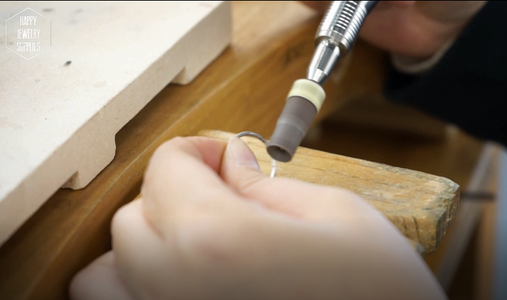

Step 5: Ring 1:Cutting and Polishing

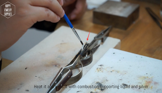

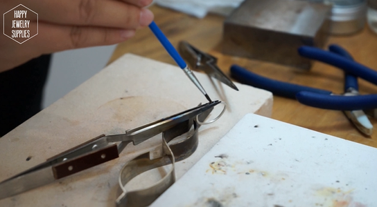

Step 6: Ring 1:Stitching and Cooling
The two ends of the ring interface splicing
With the solder powder stitching together (using the fire machine)
Then burn the black part of the grinding and polishing

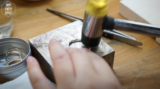

Step 7: Ring 1:Beating Solid & to Oxidize Soak
