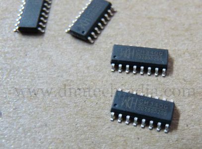

CH340g is a great new low cost alternative to other usb to ttl converter IC’s. It is also gaining lot of popularity andhas support for window’s 8, windows 10 and all OSX for MAC. It is very easy to Install and Tutorials are available for installing CH340 drivers for windows and also for MAC.
Step 4: SMD to DIP Converter
Truly speaking this converter board is the only reason that it was possible to make this project. The problem in using CH340 was that it does not come in DIP version only smd versions are available. But luckily I found a 16 pin SMD to DIP converter which made this project possible. Now using SMD IC’s is not a problem at all as variety of SMD to DIP converter PCB’s are available online.
