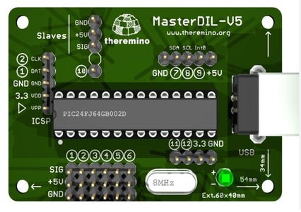

 Theremino is an Open Source system, to connect computer with the real world. Unlike similar systems (for example Arduino), this system works immediately, and does not require any firmware programming. The communication between the PC and the external components is done through "Theremino Master" board which is just an input-output device and not a micro programmable controller as Arduino.
 You can get the Theremino Master board ready for about twenty dollars or make it yourself, because the code and instructions for making it are free.  You now have more than 150 great Windows applications on the Theremino website that allow you to control the components, modules, or sensors connected to the Theremino Master board. The Thermino system uses the power of the PC and the flexibility and low cost of the microcontrollers, so with this combination we can make great device.

  - Theremino Master board
  - Resistor 22K (Red, Red, Orange, Golden)
  - Capacitor 1µF
  - and two electrodes actually two metal cylinders

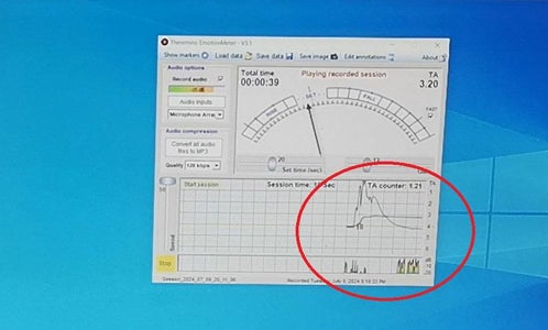

  Now, let's briefly explain how to install and run the software. First we need to download the app Theremino Emotion Meter c. 3.1 from the given address. Then we unpack the archive into a folder that contains all the necessary files. We activate the .exe file, which automatically starts the Theremino Hal application, in which the characteristics of the board's inputs and outputs are defined. In this case the Theremino Hal should look like this.
To check the functioning of the device, we should hold the electrodes with both hands, during which a deflection should appear on the scale. And now I will try to explain to you the way of working with the device as briefly as possible, and you can find a detailed description in pdf format on the website given above. he E-Meter measures changes in the electrical conductance of the skin, similar to the Galvanic Skin Response (GSR) used in polygraphs. The idea is that mental and emotional states can affect the body's electrical properties. After turning on the device, we should take the electrodes in both hands and hold them with constant pressure.
 First, the arrow deflects to the right, then slowly moves to the "SET" position. We should not have rings or other metal objects on our hands. It is necessary to hold the electrodes with a constant pressure until the he arrow rests on the "Set" position. In order to check the functionality again, we should briefly press the electrodes strongly, during which a deviation to the right should appear again. When the arrow settles at the set position we can start testing. To be honest, I have always been skeptical about this type of device, but this time I was very pleasantly surprised with its functionality. We are most sure if we test the functioning on ourselves.
  For this purpose, when we bring the arrow to rest, we should start a favorite song or video that causes positive or negative emotional changes in us. At the same moment, the arrow begins to move towards the Fall position, which actually means a decrease in the surface resistance of the skin caused by emotional changes. If you follow the manufacturing and testing instructions, you won't believe how sensitive and functional is this device. After all in this claim, you will have to assured for yourself, because there is no way I can demonstrate it to you in a video.
 Otherwise, this device has many more advanced and extremely useful functions than the original Emotion meter device, such as a graphic display of the entire session as well as an audio recording of it in mp3 format.
When we are done with the session, we need to remember the recorded material, and then we can play it again at any time, depending on the needs
