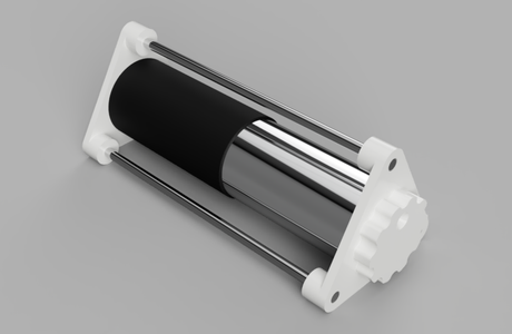

To make a variable capacitor we need to vary some parameters upon which the capacitance depends, as we saw in the previous step the capacitance value depends on the area and the distance been the parallel plates. We will change the area of interaction of two parallel plates to vary the capacitance.
Our solution will consist of two cylindrical aluminum foils whose area of interaction will be controlled by the rotation of a threaded rod. It will provide precision control over the range of the capacitance.
Only the area of cylindrical foils which are directly over each other will contribute to the capacitance.

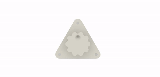

Step 4: 3D Printed Parts
There are two main and some side parts: The Left & Right Panel, Cap for Threaded Rod, and some parts to hold the foil. All the parts are printed without any supports with three wall perimeters.
I have also attached the Step file in case you wish to tweak the model to your needs.
Note: The bearing parts are optional if you have a bearing of 4mm ID and 12mm OD then you can skip printing the bearing parts or you can use the solution I have utilized by converting a roller bearing to these parameters.

The Right Side of the Assembly consist of mainly two parts upon which the inner foils will be wrapped on.
Stick the double-sided tape on both the cylindrical 3d printed parts and wrap the foil around it.
Do note that the attached wire should be coming out from the side which will be going inside the outer cylindrical foil(as can be seen in the images) so that there is less strain on the wire while moving inside the assembly.
After wrapping the foils cover the joining part with some transparent tape so the structure becomes rigid and the foils don't get apart in case of movement.

There are holes on the exterior of the left and right panels.
The holes on the left part are slightly smaller than those on the right so that the support rods of 2mm fit snugly inside the left part and the right part can move freely on the support rod.
First, connect the threaded rod assembly on the right part( i.e. the one attached with the inner cylinder). The threaded rod should rotate freely when it is connected to the right part and the bearing should fit snugly in there. Now, fix the three support rods on the left part.
Note: if any of the connecting rods is free on the left assembly then use some Teflon tape to increase its diameter and then fit it rigidly inside the left part
Step 15: Connect Both Parts Together
Now connect the support rod to the right part and it should move freely on the rods & the inner cylinder should slide inside the outer cylinder.
Finally, thread in the threaded rod to the fix we secured into the left part.
With this, the assembly is finished.

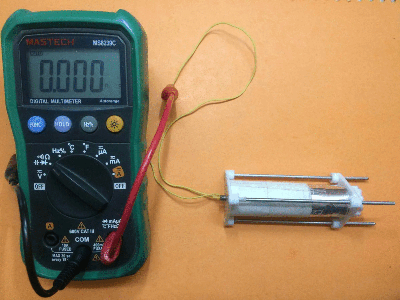

Step 16: Lets Measure the Capacitance
Now let's measure the capacitance with the help of a multimeter.
The one we just made measures a range of 0-45 picoFarads.
If you want to make a larger one you can make multiple layers or increase the length of the cylinders.
Step 17: Woohoo! You Have a Variable Capacitor
Yeah! you made yourself a variable capacitor that is precise in control and provides a wide range.
