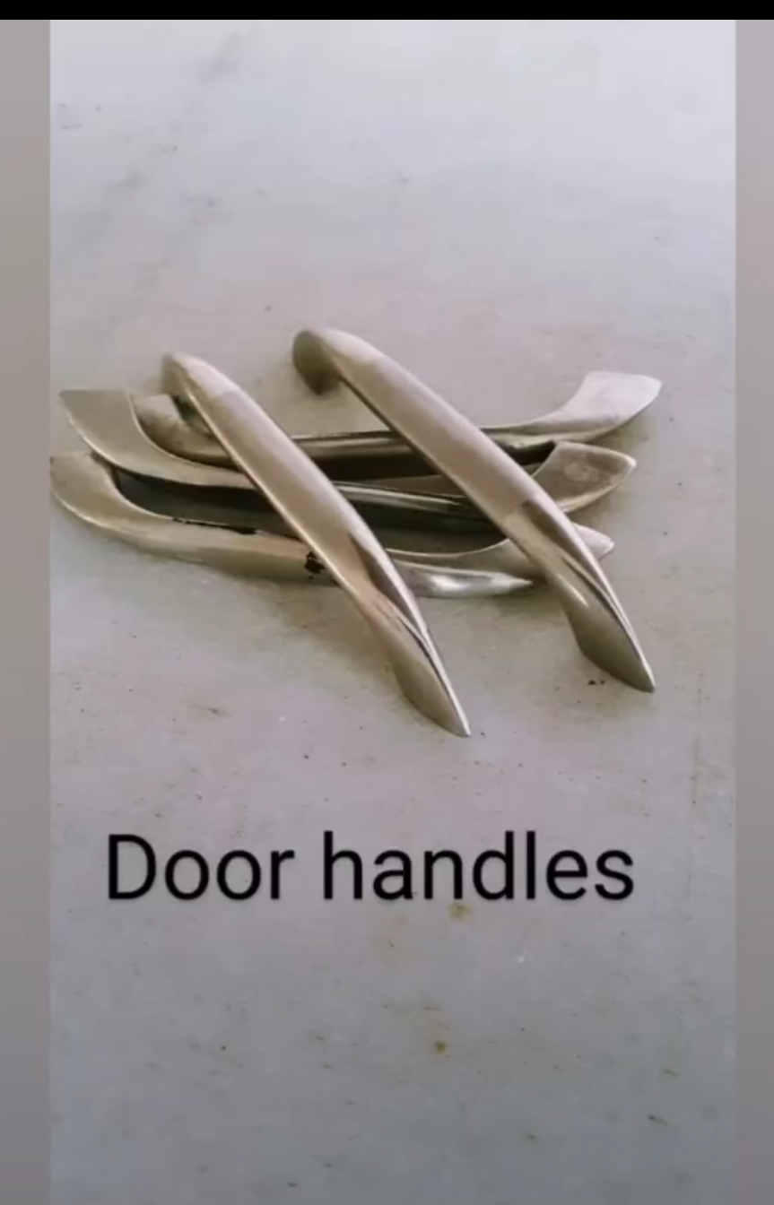

-wood board (I used around 4 by 1.5 feet but size can vary as required)
-Door pulls/handles(6 pieces or as required)

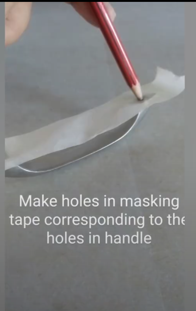

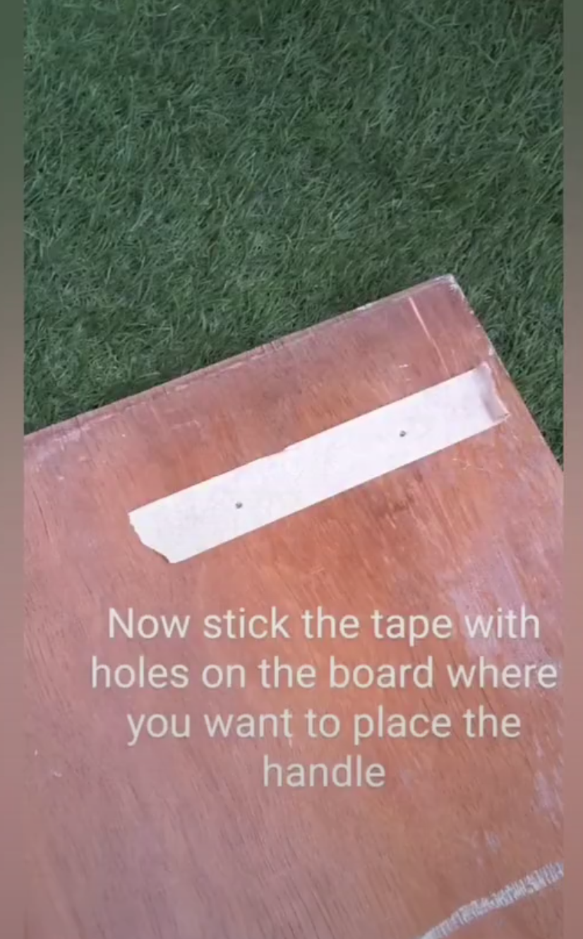

We will install one door handle in each section on the board. To mark the position of holes first stick a tape on the handle connecting both the holes. Then pierce the tape over the holes. Now remove the tape and stick it on the board where you want to place the handle( hang your plant). Drill holes on the wood board over the holes in tape. Similarly drill holes for one handle in each section.
