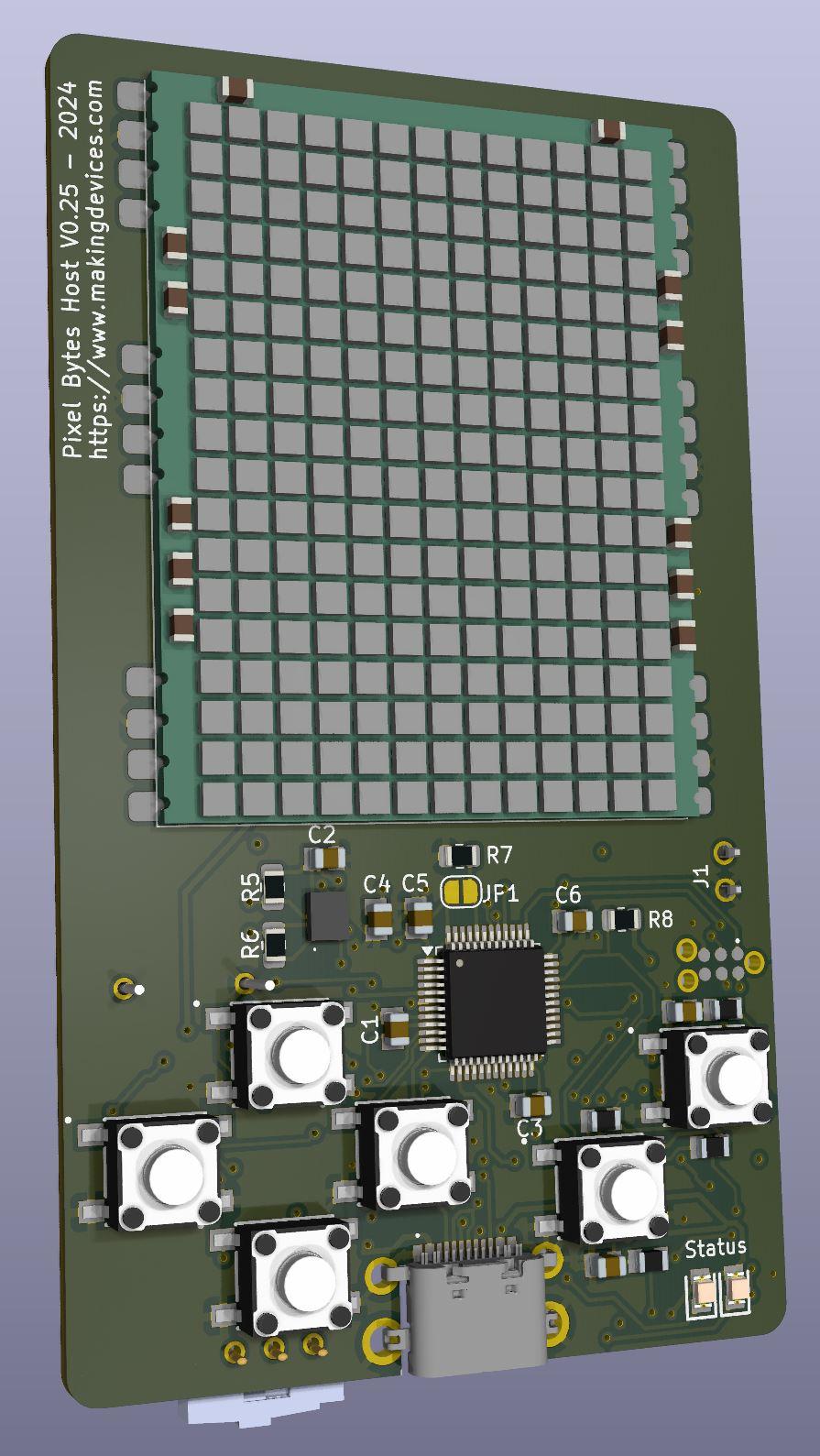

Step 1: The Screen
The screen of 234 (13*18 matrix) from Wurth Elektronik is formed by a matrix controlled by just one pin of the STM32F103CBT6. The display can light with any RGB color, but they need to combine the three of them to show white.
In addition, a NPN transistor is used so we can turn on or off the power of the screen. This is neccesary due to the power consumption of the internal IC of the addressable LED.
Finally, the display is a separated board, so you can assemble it more easily. You have castellated holes so you can solder the display to the pcb-host once everything is soldered.

Step 3: The Main Chip
The circuit is built around the STM32F103CBT6. It is a 32-bit microcontroller with USB capabilities, which will be perfect for the development of the bootloader and the later integration with the arduino IDE. It has 128 Kbytes of program memory size and 20Kbytes of SRAM. The frequency can go up to 72MHz.
Even if we only use one pin for controlling all the display, we have several IO pins for the buttons, the buzzer, the voltage measurements for the battery and also the accelerometer from Wurth Elektronik.
Step 4: The PCB Design
As said before, the project consists on two pcbs that are soldered together once everything else is in place. Both of the PCBs are four layer and you can access the Kicad project and the gerbers in the github repository as everything is OpenSource
