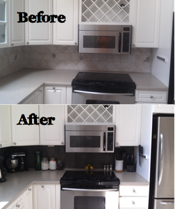

We just bought a new house, and down the line, we will do a full kitchen renovation. For right now, however, we wanted to change up the backsplash, but didn't want to rip out the old one or spend a lot of money. The solution = Vinyl Peel-and-Stick Tiles.
These steps will include both a temporary way to install the tiles and a more permanent way to install the tiles. The steps are the same with the exception of using one material over the other. Please read through all of the directions and feel free to contact me if you have any questions or concerns.

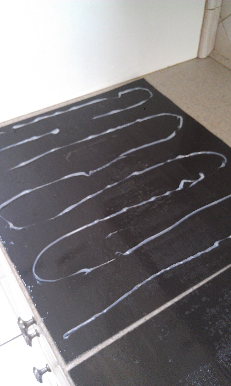

Step 4: Apply the Silicone
***FOR PERMANENT INSTALLATION ONLY***
If your tiles will only be a temporary installation and you wish to save the original kitchen backsplash, please follow Step 3. Otherwise, please use the information below for a more permanent installation.
Clip the silicone tube into the caulk gun and cut off the tip to the desired opening, or approximately 1/4".
Remove the paper backing from the peel-and-stick tiles. Apply the silicone to the back of the tiles in a snake pattern, that way air has the chance to escape from either the top or the bottom of the tile, and there won't be any pockets in the middle of the tile.

Step 6: Finished Product
Once the tiles are set, 24 hours if you are using the temporary method, or 1/2 hour if you are using the permanent method, you can put everything back on your counters and remove the supports that you may have put up!
Your work is done and now you can enjoy your new kitchen backsplash!
